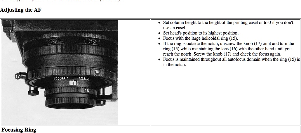

Thanks for this ... and thanks, Hans ... I had read that site thoroughly. I've attached a screenshot from it.
I'm not sure what "notch" these instructions refer to.
"Focus with the large helicoidal ring (15).
If the ring is outside the notch, unscrew the knob (17) on it and turn the ring (15) while maintaining the lens (16) with the other hand until you reach the notch. Screw the knob (17) and check the focus again."
How do I identify the notch that the focus ring will or will not be outside of?

I *think* what he's referring to is...
When you turn the focus ring it drops into a notch and kinda *stops* there but you can turn it further and it pops out and continues on its travel. Have a go turning the focus ring and hopefully you'll see what I mean.
