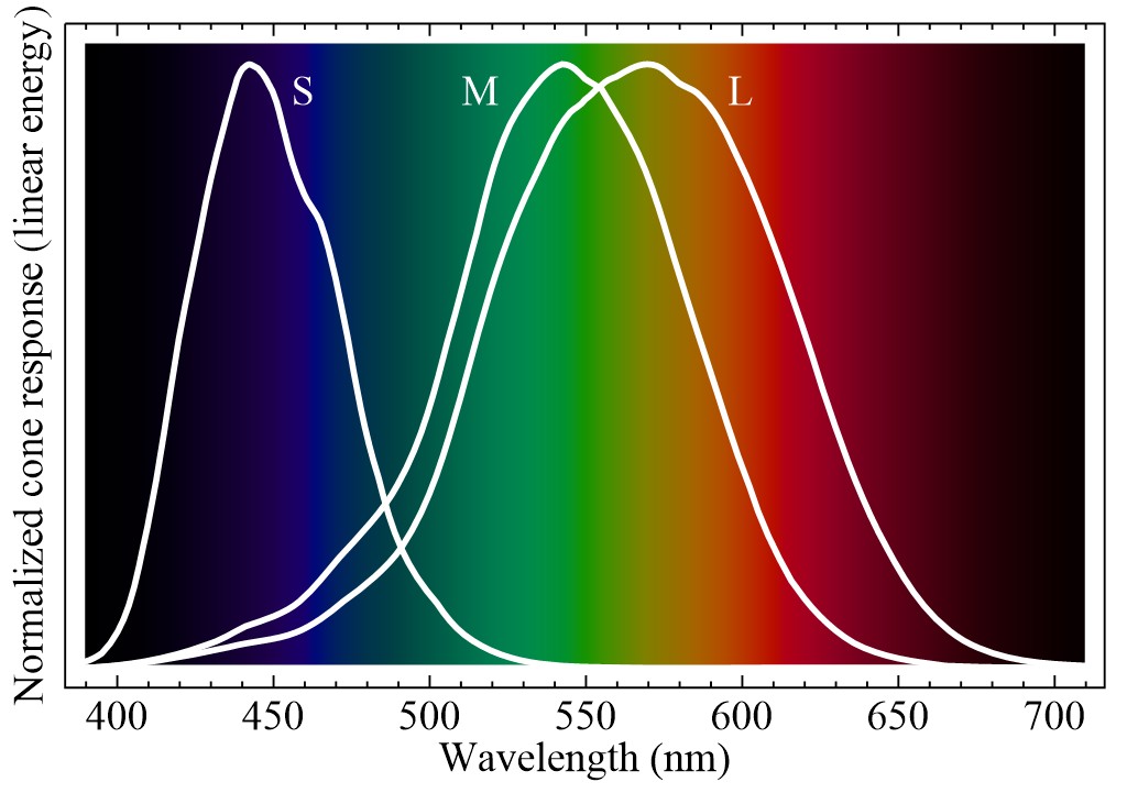

Generally, making films (or semiconductor detectors) more sensitive in the infrared is difficult. Speaking very generally, photons in the near-IR have lower energy than photons in the optical, so they are less likely to activate a photosite and be absorbed. Thus, infrared B&W emulsions probably have fairly sophisticated sensitizing dyes that allow the absorption of near-IR light and convert it to the activation of silver.
The opposite is true of the blue and near-UV - blue photons have more energy and more easily provoke a reaction, that's why early emulsions were blue sensitive and it took longer to develop ortho and then panchro film.
There were once specialized blue and red and near-IR emulsion on plates for things like scientific astrophotography - IIIaJ, IIIaO, IV-N, etc. All gone now. The amount of R&D in emulsions like these and HIE was no small matter.
