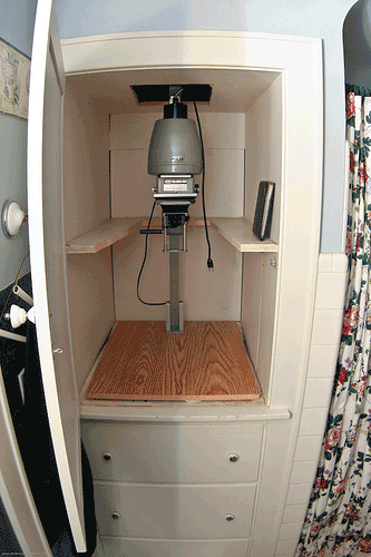

Best to buy a x100 off box of postcard (VC) and try only easy negatives when you have finished the box go larger.
I have lost all photos of my first darkroom did 35 and 120 film. It was in a small bathroom did prints up to 16 x 20
For 8x10 I use a board over the sink for the trays. For up to 16x20 use set of shelf in the shower.
The enlarger was in side the towel closet would do up 11x14 if did 16x20 just set on sink board
I did find a photo very close to mine on the internet for the enlarger it even same Bogan 22a.
Dave
