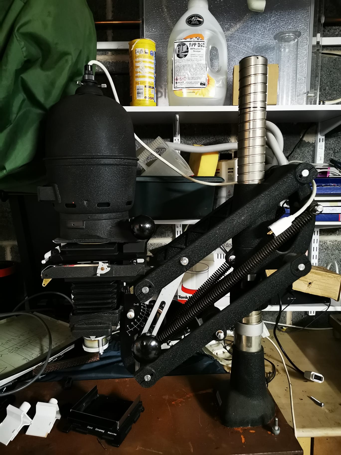

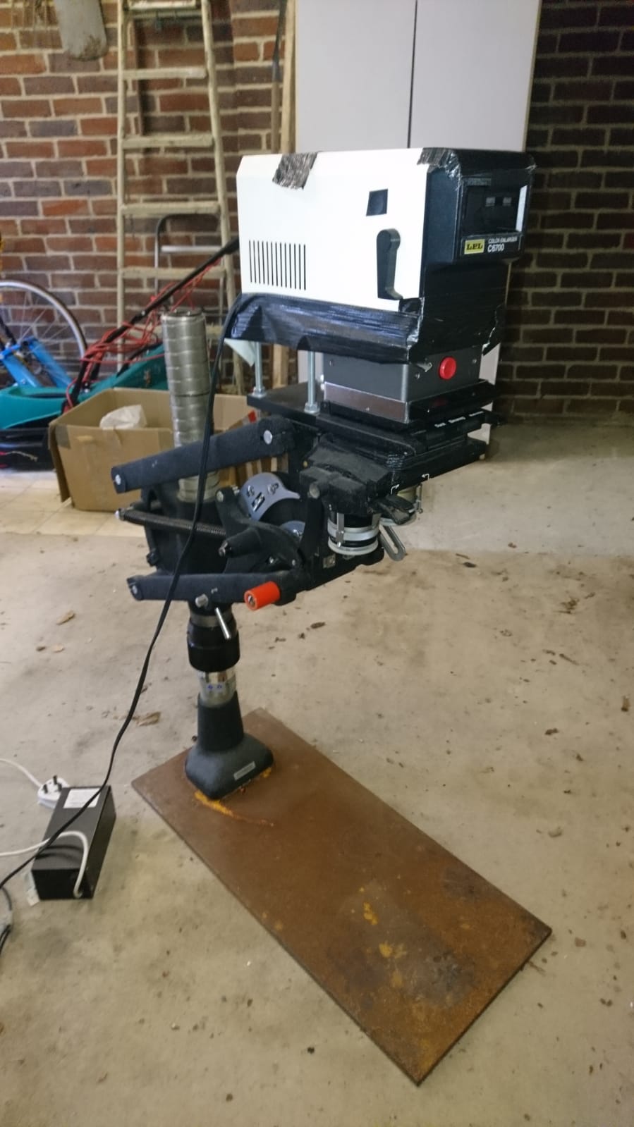

I have just rescued a badly modified iic. It had a durst mixing chamber and lpl colour head bolted on and a heavy piece of steel instead of the baseboard. 60 and 100 lenses and focusing stage look ok.
I have sourced a iic condenser head lamphouse and 35mm negative carrier. And correct wooden base. Leica eazel and colum set for 3cm baseboard.
Cams both move the focus stage smoothly...
Lenses both nice bright glass.
It looks great but the 60 focotar focus is way off. I can only get it to focus if i screw it most of the way into the helicoid and locking the focus stage to zero extension. This cant be right! It sticks so far into the enlarger one can not slide the platform to change lenses.
In this position prints are tack sharp but cant print more than 30cm long axis.
The 100 elmar focuses fine around middle of helicoid within range of its limiter and focus stays sharp with cam over whole range.
I can only assume i am missing something obvious. It all looks complete. The 60 lens doesnt appear to be missing any elements and it is very sharp all beit in a very odd setting and no auto focus.
I am hoping this is something that a regular user might have come accross. Have couple of pics before n after. Iron base also gone now replaced with correct wooden one.
Any suggestions gratefully received.
Richard

When you stand in front of the enlarger, is the 60mm positioned on the right and the 100mm on the left?
Then, in the first picture your IIc lacks the Bowden cable. It looks like a cable release running from the left of the slider backwards and down. Do you have that cable?

One thing: when you push the slider to the left to bring the 60mm in place, are you pushing the slider also upwards as indicated by the arrows?
When you don't and you use the screwdriver to push a metal 'wheel' out, that will land against the cam and not on it as it should.
When the wheel has landed on the cam it will follow the curve of the cam when you bring the enlarger up and down.
Richard

On this basis the abnormal focusing had to be because the negative was too far from the lens. Not easy but after careful studies of pictures on the net i discovered an extra 1cm slab of metal which was nicely machined and looked original. It must have been put there to adjust things for the colour head conversion.
You can see an extra step on my pictures! Removing this and focus is perfect. The only hassle now is sourcing 8 of the correct screws to put the bellows onto the correct surface. It had been crudely fixed with adhesive.
