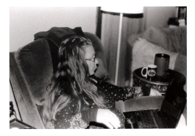

This is iso 160, flash-1/60 f11, D-76 1+1/13 mins @20c., with 3 min presoak, stop and three min fix.(clip test cleared 55 secs)

Might not have an anti halation backing? The glow on the white hand in the sample image seems a bit pronounced.
Then again if it was CRT recording film, it would not be built to see and record anything all too bright in the first place.
From what I can see, it's a fairly decent film with a bunch of grain. I'm assuming her hand picked up a lot of the flash but it's strange that it had no more affect than that.
It had alot more glow than that, I did a burn in to tame it some. There isn't an AH coating and the flash really made her hand pop out. I have some Benzotriazole, am going to use it next batch.

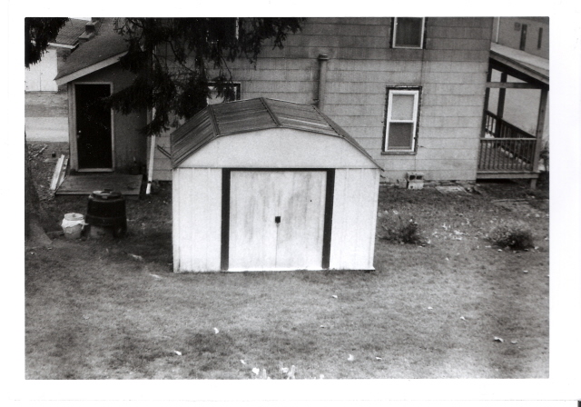

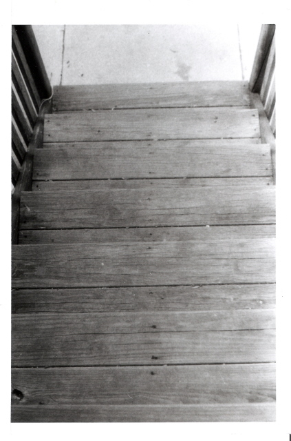

A couple of new test shots, Canon AE-1 with 1.8/50mm, rated film at ie 25, developed in Rodinal 1+100, one hour stand development at 70f. Seems to have tamed the contrast and the grain isn't too awfully pronounced. These are straight scans of 5x7 prints at 600dpi, no manipulation.

Rick, do my eyes deceive me or does it appear that the canon has a light leak along the top. If you look at the right side of the steps and along the bottom of the second pic it looks lighter than it should. Correct me if I'm wrong.
Joel
No Joel, the AE-1 is definitly in need of new seals. I wanted to check it out prior to selling it, no better time than when testing this film as well.
