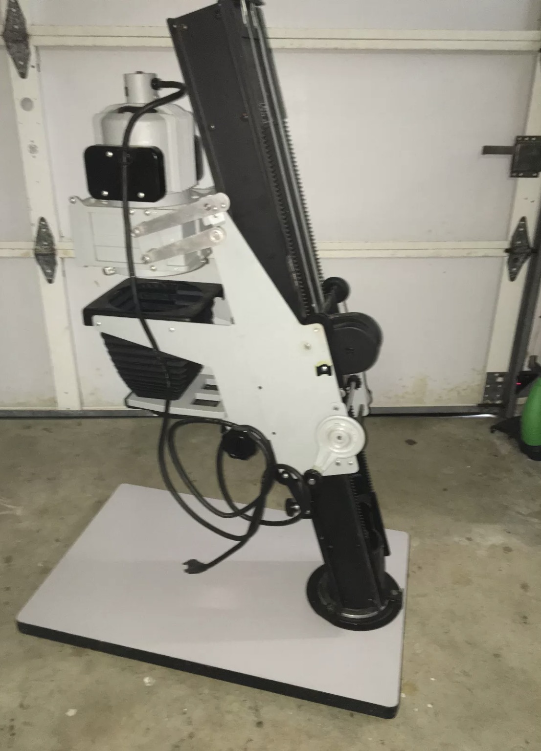

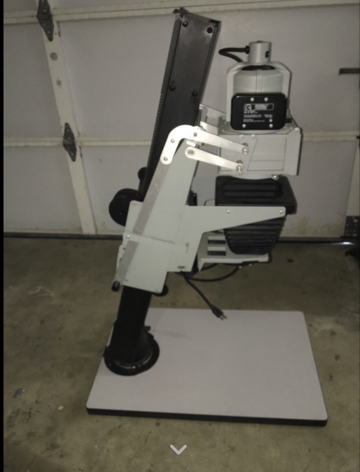

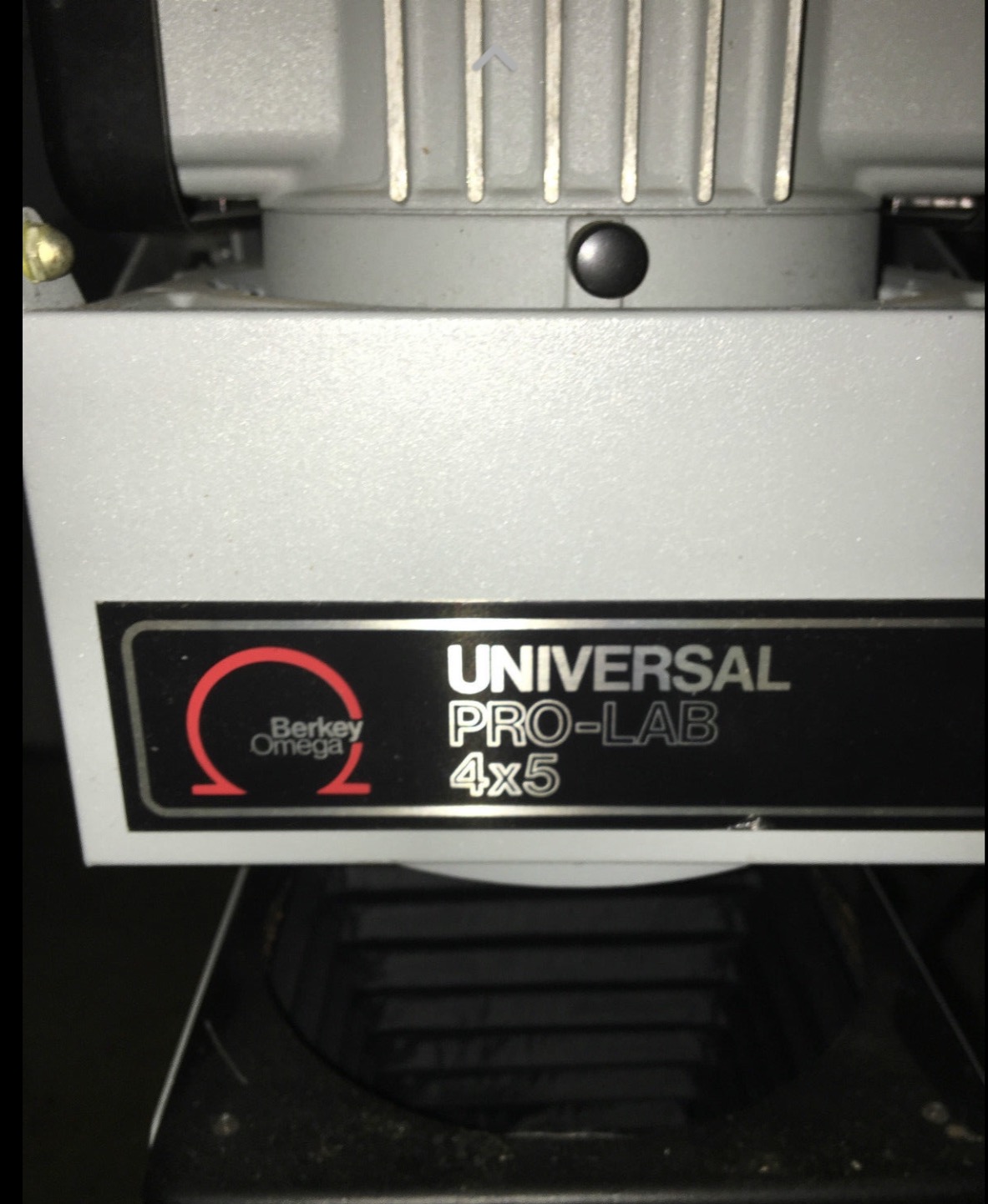

Hello all, I am hoping someone can help me identify the model of enlarger in the attached files. It says it's an Omega Universal Pro-Lab 4x5 but I can't seem to find any info on it. I find information regarding the D series enlargers but nothing on this particular one. I'm obviously new to this and appreciate any and all help. Thanks, Tom

I have one sitting in my DR and it's a work horse. What would you like to know? It accepts all D series parts, does NOT require spacing cones for different focal length lenses, should have a fixed set of condensers plus a variable condenser in the upper head. If the condensers are missing, I have an extra full set, plus I have an extra three lens mounting turret. It uses 6x6 inch VC filters, I have a couple extra sets of those as well.

Buy it! I think it is the Super D6 Pro-Lab which was a premium version of the D5.

I don't think so, because it doesn't have the fine focusing module, and I believe all the D6 enlargers have that module. But it is an excellent enlarger.
The last photo you posted hints at there being a name and information plate on the back of the large black support girder, near the top. What does it say? :smile:
I have the older version of the D6, but the KHB information on it talks about the newer D6 as well: http://www.khbphotografix.com/omega/Enlargers/D6.htm

Yes, maybe it is a gray D5, like on the cover of the D5 manual. If a D6 it might have this plate below. Either way, it looks like a fantastic enlarger if it is in good shape.

Looks like a D5 to me.
I have several of these and the labels seem to vary.
One I have has a D-5 label on the cross brace like in the picture above, another in which I cannot find a label and another in which there was no label until I found it had fell off and was sitting in the hollow of the base mount. Also colors of various chassis parts seem to vary.
Either way just about all the later D variants function and work in the same manner and most parts or accessories are interchangeable.
You can't go wrong with one of these enlargers as long as it is not terribly abused.

Thanks again everyone for replying to this post. It is indeed a D5 and is in pretty good shape from what I can tell. The one issue that I have found is that one of the rivets that secure the handle has popped making it impossible to lift the head one handed. I was planning on removing the rivet and just using a bolt and nut to secure it unless anyone else has a better idea? Also, does anyone know what lens board fits the el-nikkor 150mm lens? I bought one off of eBay that said it was for 150mm lenses but it was too small.
