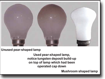

I don't think the lamp is adjustable on that one. Are you sure the globe of the lamp is free from irregularity? Sometimes opal lamps form blackened areas on the globe and then need to be replaced prior to burnout.

Ok, after some tests i've discovered the problem was the actual lamp. The metal luminescence part was forming a curved form almost like a "C" leaving the right part a lot less illuminated..
The diffusion glass in the filter carrier cannot diffuse this type of light enough to be equal
I've currently replaced the lamp with an led Ikea Lamp 75W which is working pretty good!
