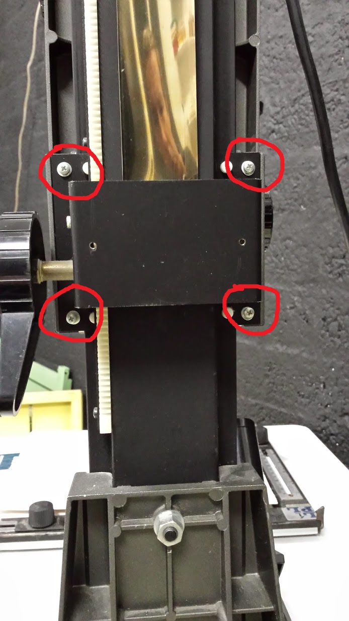

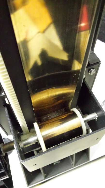

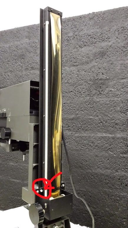

I am sorry for dragging up an old thread. I couldn't find a newer one here on apug. My head of the M605 is sliding down. I have read about the pressure pads but I could find them on my enlarger. Can anyone post some photo's where I can find them? Here is a photo of a spring on my enlarger:
The carriage that slides up and down the column - Across the back (where the other end of the pictured spring attaches) is a steel plate. Behind this plate, there should be four white plastic buttons.

Glad you managed to fix it, Peter. I too got concerned when I saw what appeared to be one post which suggested it was hard to fix and another from Ian Grant which gave me hope, should it happen to me.
Faith in Ian's solution, backed by paul_c5x4 was well placed
