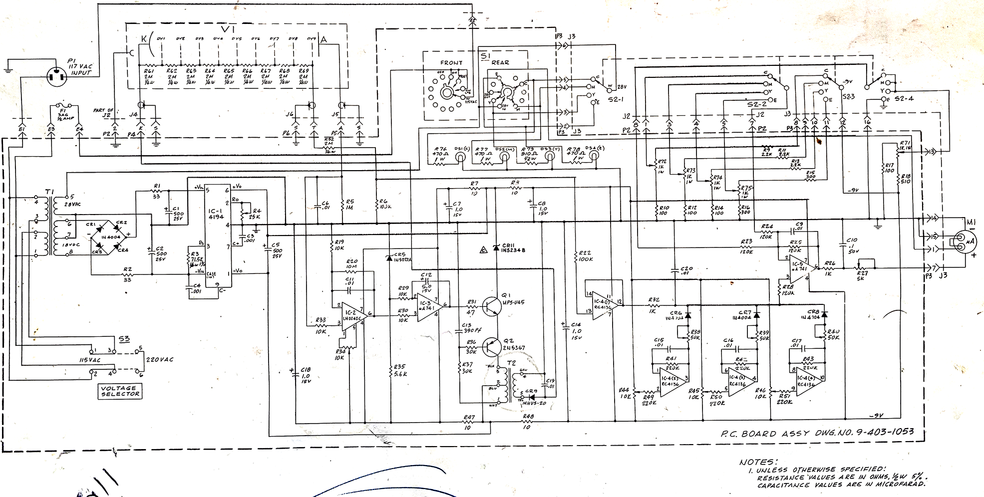

Rescisitating this old thread because I have two of these Chromegatrol Pro Lab analyzers. One turns on but won't read anything. The other works as an exposure meter but none of the color programming works (meter reads nothing in C/M/Y modes no matter what I do to the dials). If anyone has advice that might save me some time bringing at least the half-working one back to life and immortalize their knowledge to posterity, it would be appreciated.
I bought these for about $25 each, whereas there is only one on that auction site now that accepts returns, and the prices are generally $150. I have the schematic (posted), a hobbyist's electronics experience, and a handful of electrical engineering classes under my belt. I would rather use that knowledge and a few hours to build a working unit than deal with the frustration of waiting for other more expensive and probably broken units.
