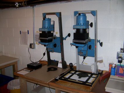

This is exactly the same situation I had! I got a second lens board and life was considerably easier! Then, I found a second enlarger, just like the first, and life was a dream! :D

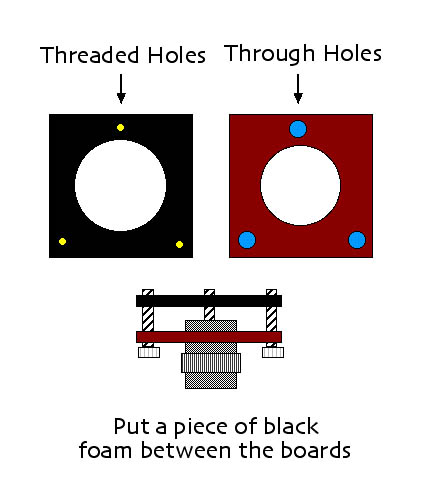

Old timers often used an adjustable lens board to fully align the lens on a Beseler enlarger, and Fred Picker used to sell them. Cap screws work well. I made lots of them, and either 3 or 4 screws work well.
It looks like this:
Wish I had room for a second enlarger! I would love to be able to just set them up and not have to change anything out. But, I am working in a VERY small area.
