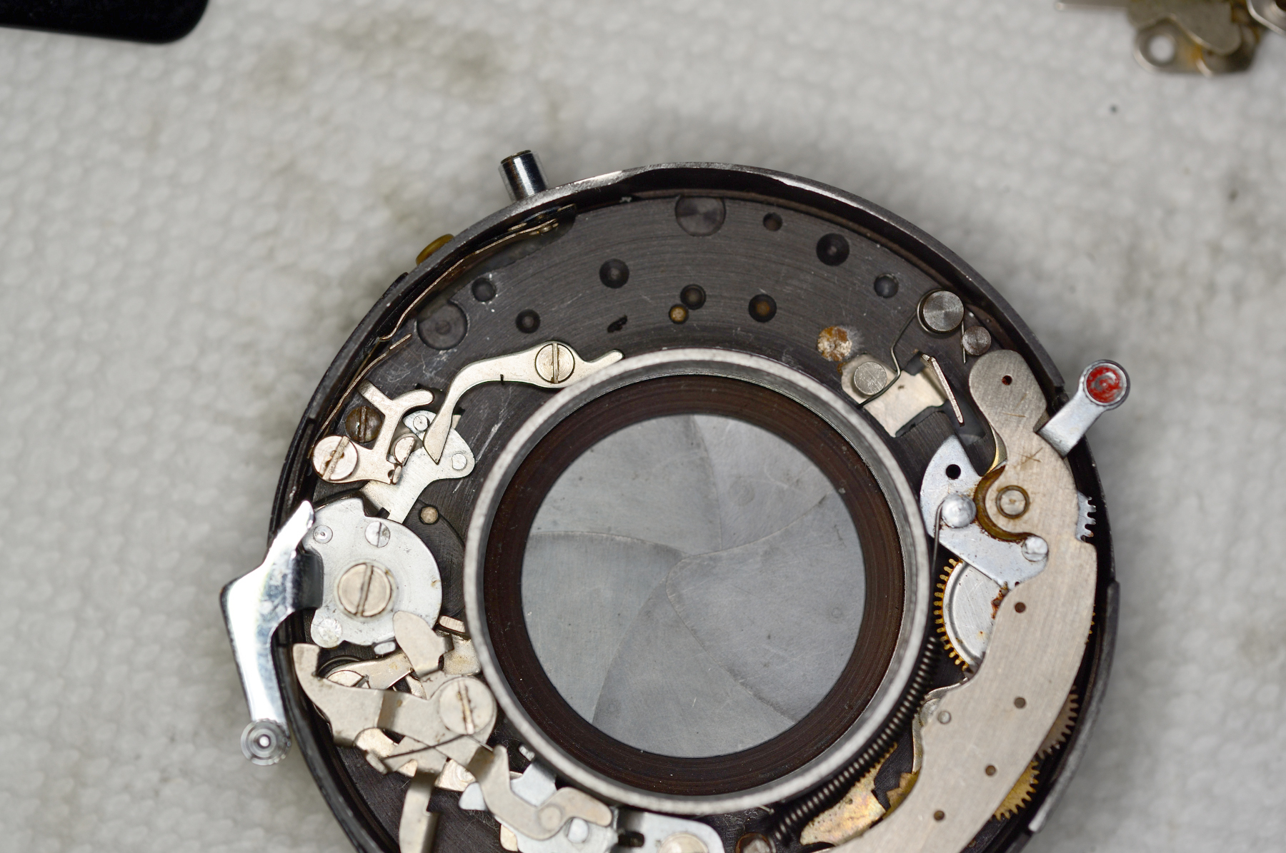

This is my Prontor S with the delay timing removed.
With the spring connected as shown in the picture the blades do not move when setting the shutter, with the spring disconnected from the blade controller lug the shutter blades move but do not open. This may vary with wear.
