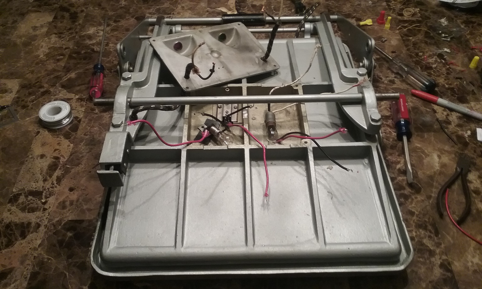

Hi there, So I have a Seal 150 (Im pretty sure) dry mount press. The wiring was causing a short as many of the wires were loose. Now I have gone and messed up. I forgot to take a picture of the wiring before I started taking things apart. Now im lost and feeling like a moron. Could anyone please point me in the direction of a wiring diagram for this thing? (It does not have an on/off switch) Or attach a picture of theirs so I can get this done correctly? It worked well before I took it apart except for the shock I got when I touched more than one point on it at a time. I replaced the wires with modern wiring, Now im just not sure how to properly reconnect them.
Time is of the essence so a quick reply would be awesome!
Thanks!

AC wiring 101- 110V - Black is the hot lead, white is neutral, green is ground; 220V - black is leg 1, red is leg 2, white is neutral, green is ground.
Light sockets, center contact to hot lead, case lead to neutral. Both/all heating elements connect with the same side connected to hot. A ground wire can be added from the press frame to the round lug on a 3 prong plug to help prevent shocks. When a short occurs a circuit breaker/fuse will trip/blow. I would replace the power cord also, cloth covered wire has not been used for a half century or so.
I do not know if there are switches to turn on the heating elements or if the lights are to be in series or parallel with the heating elements.

You don't have an on/off switch nor a rheostat to adjust the temperature? I wouldn't solder any of the connections once you get it sorted (or shorted...) :smile: out. Best wishes

I do not have an on/off switch, but I do have the thermostat. It may be hard to see in the pic. I am basically looking for a wiring diagram. It all worked yesterday but several of the wires were worn showing exposed wire etc. So I replaced the wires with modern heat resistant wires. Thats why they look cloth wrapped. But all of the red/black wires are new. Anyways I am hoping for a wiring diagram which i have yet to find online, or a photo of a same model that is working. Thanks everyone!

I actually got it figured out. I found someone on ebay with one for sale that sent me some pictures of the wiring. And it works great now. I am constantly looking for other presses. Next time I think I will make sure the wiring is a bit more tip top before buying instead of a hodgepodge mess. But the good news is that it is working properly now, and after the rewire and thermostat cleaning I can get back to business. Thank you all for your help! It is much appreciated!
