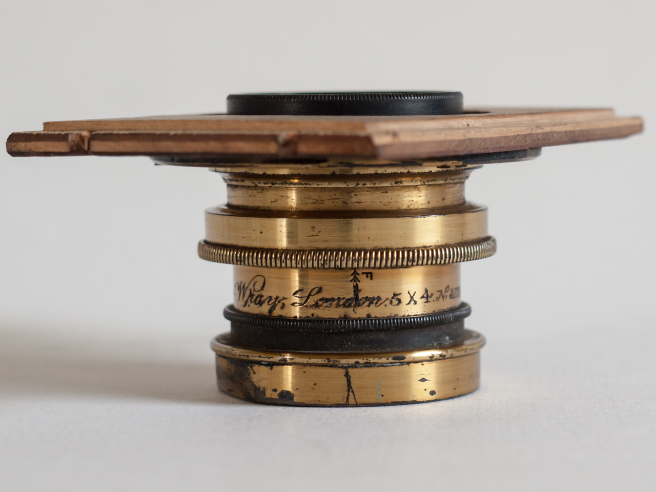

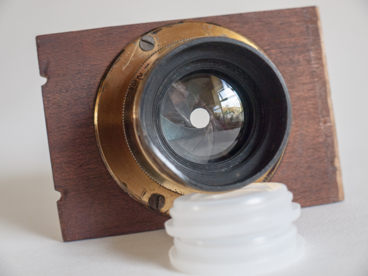

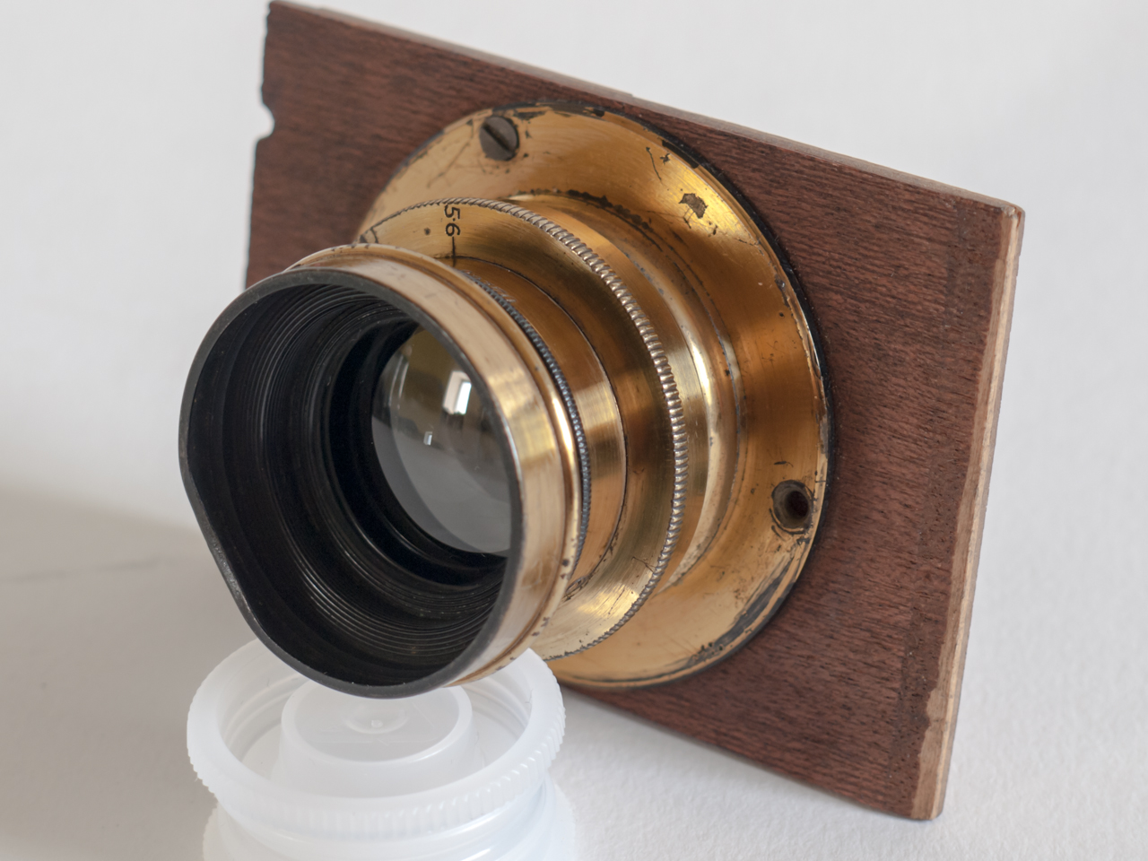

This has recently come into my possession. Pity it's not for 8x10, but for nothing one can't be picky.
I know there were zillions of lenses made early in the last century, but it would be nice to know any further details than the obvious ones.
Engraved "Wray London 5x4 No 3170" & aperture scale f/5.6 to 64
Two elements which both unscrew and appear interchangeable. 10 bladed iris. Homemade lensboard as you can see.
The focal length seems to be 5" (estimated by ruler and sharpness of image thrown on the wall :smile:)
If I remove one element, it still seems to throw a decent image and the focal length is doubled.
Am I correct in thinking this is a "rapid rectilinear" type?
Any ideas as to age?
Any further information?

It might be a Wray Portrait RR. Serial number, maximum aperture, and plate size are consistent with this. If it is a Portrait RR, each cell will be cemented doublet, concave to the diaphragm and convex to the end of the barre.
Pretty thing, innit?

Thanks Dan and yes, it is impossibly cute!
The cells are convex/concave exactly as you describe, but I simply don't know enough about lenses to establish their construction.

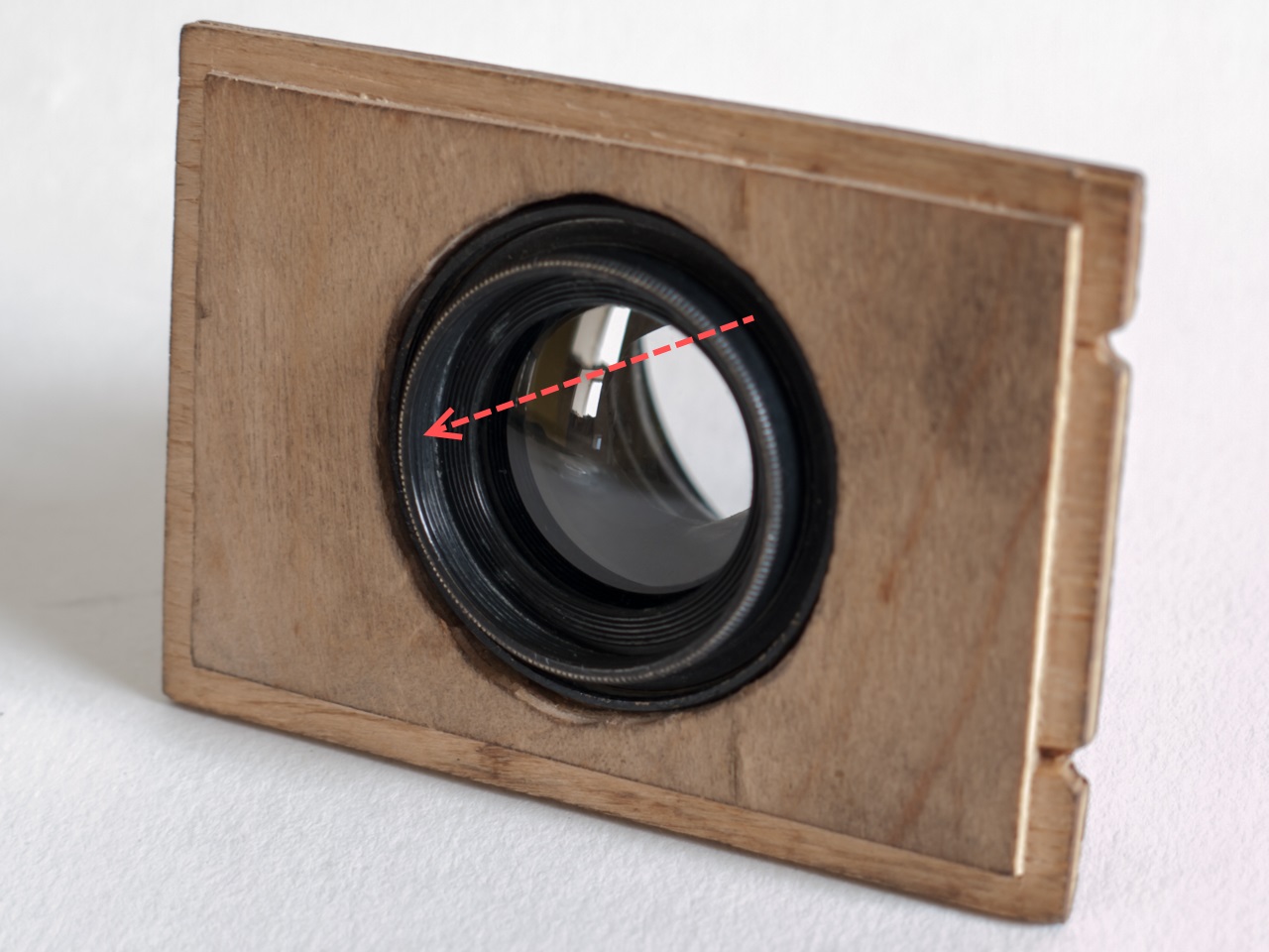

The rear cell has a male thread that screws into the mounting flange, but at the rearmost of the cell there is a female thread (see arrow in attachment); it's this I am referring to.
Female threads like the one you asked about are there for several reasons. The most likely is that the rear group/element's retaining ring screws into it. The next most likely is for a rear mounted filter. I have several TTH lenses that are threaded internally at the rear; with them the threading seems to be there to tame glancing reflections from the barrel.
I've had SKGrimes take advantage of some of my lenses' rear internal threads for mounting lenses on boards (retaining ring screws into, not onto, the rear of the lens) or in front of a shutter (adapter screws into ...)
