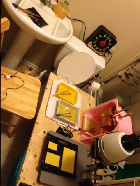

Film developing temp is easy.
Get a dial or digital thermometer.
Use a small tub with 1-2 inches of water at the correct temp.
Problem solved. At least that is how I did it.
I made a 35mm/6x6 printing darkroom in a small half bath. By small I mean less than 36" wide x about 6ft. The enlarger was on a small table over the toilet. And it is broken down after printing, since it has to function as a half bath. I set one up in an apartment, similar to Ko.Fe.'s pix. And in high school, my brother and I took over the kitchen at night, putting blankets up over the windows. So if you really wanted to, you can set up a printing darkroom at home.
