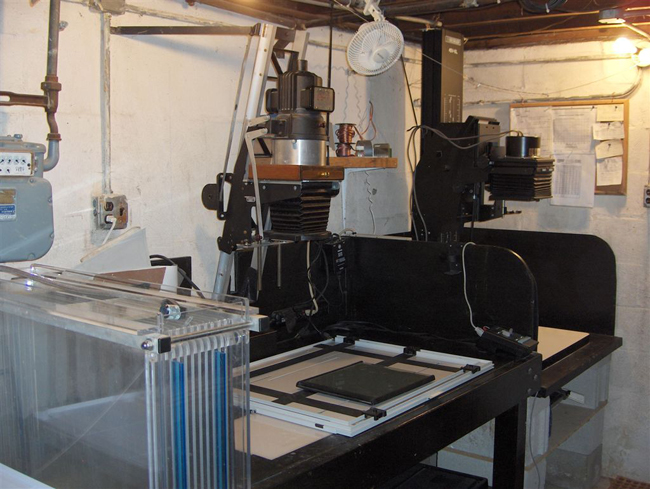

One other point: I would avoid using below-the-lens contrast filters if at all possible. Try to devise a filter drawer that goes above the negative with a diffuser under it. I made one for my old Omega D2 that works beautifully. I have yet to devise one for my 45V-XL but I do almost all of my printing with my venerable D2 anyway.
I'll try to attach a picture here that may give you some idea for a filter drawer. You can see the one I made in the picture. It has a drawer that holds 6x6" contrast filters and it's bottom is a diffuser. It works beautifully.
