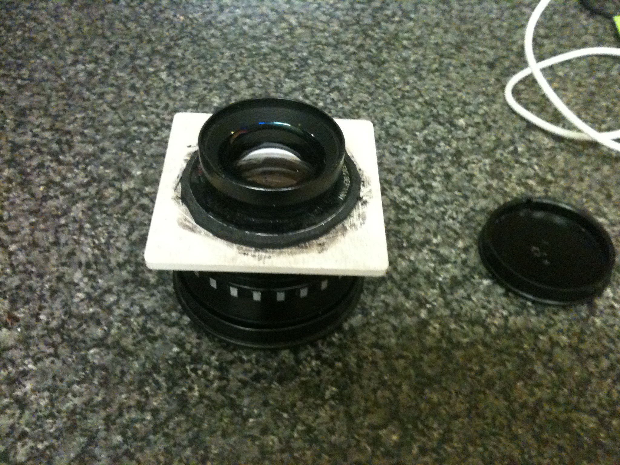

I bought a similar 135 componon, 135mm, oddball thread size. I just found a step-down ring with the proper thread to use as a nut, and cut a lens board hole a bit wider with a hole saw and some oil.

The solution in post #9 ought to work. 40.5 mm x 0.5 mm is a standard filter size. Thus, a step ring with 40.5 mm x 0.5 mm female thread on one end will work as a jam-nut if that is the thread size on the lens.

Works fine for me, but you need to remember it's a step DOWN ring, where the threads are on the inside of the ring. I took a file and made 2 notches in mine for a spanner to hold.

For my 50mm thread Rodagon to fit my Kodak Precision, I made the hole just large enough in a lensboard and used Sugru (silicone putty) as a jam nut.
