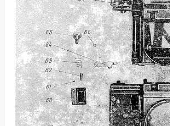

If I remember correctly , you need to peel the leathered and oncover the area around the shutter relese. Then remove the screws and remove the shutter button. I agree, it is not show anywhere on the repair manual, but only on the part list:

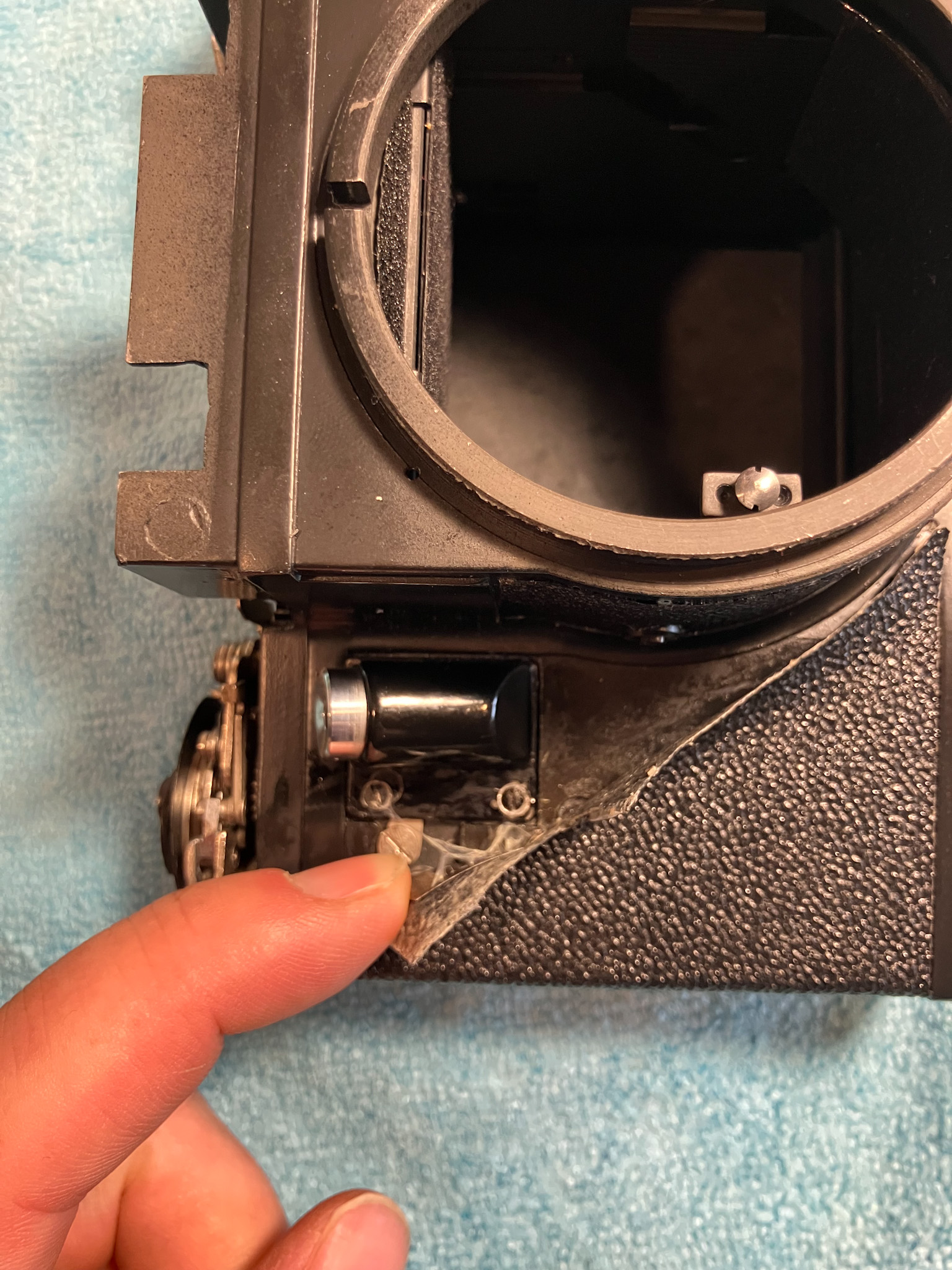

Ding ding ding, I reread the manual and double checked the noted figures and its definitely pointing at screws around the trigger.
Lifting the leatherette it’s obvious.
Thanks for the help!
