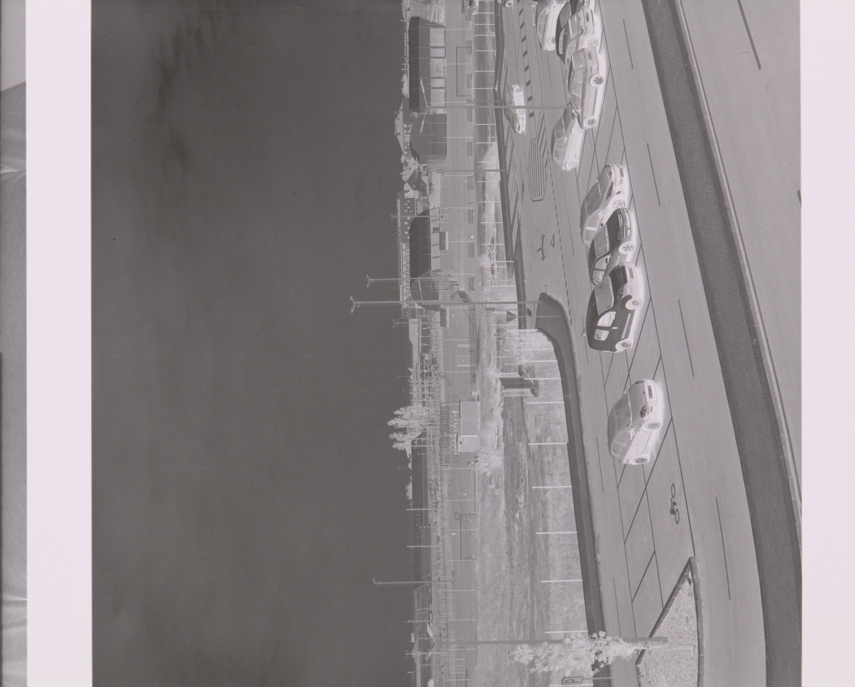

Are you able to see the defects in the negatives when you view them with a magnifier and a backlight?
Scanning adds a whole bunch of variables that make it difficult to solve issues over the internet.
Also, can you share a digital photo of the negatives themselves, backlit, showing at least a couple of frames as well as the edges of the film, the edge printing (if any) and the space between the frames?
Digital images upload well if they are resized down to 1000 pixels on the long dimension and uploaded from a jpeg with quality 80.

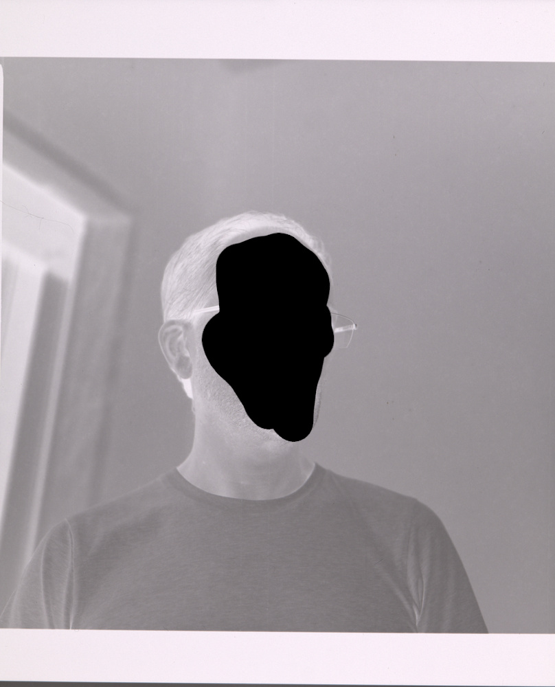

These are two unedited shot of the negative I used, they have a bit of the border between frames. Unfortunately my scanning setup for 120 is still a bit barebones so I don't have pics of the edge markings, but Fomapan also doesn't have many. I find it very hard to discern detail using a negative and a magnifier, it's like my brain just sees white.
MattKing
Apr 24, 2005
54,714
Delta, BC Canada
Are you using a scanner to scan, or are you using a digital camera to digitize by photographing the negatives?
I definitely see the scratches in the negative of the person, but I'm thinking the blotchiness may be a scanning or digitization artifact, because playing with the contrast makes the blotches look very digital.
