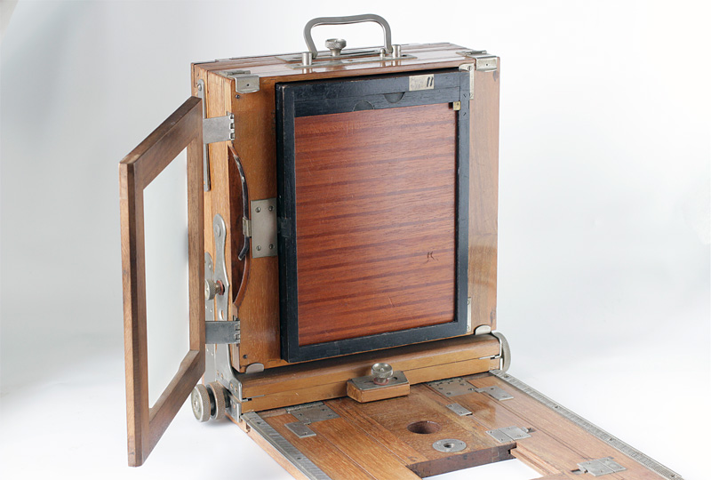

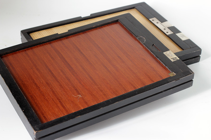

I have 6 5x4 double sided plate holders but these are quite distinctly unique as the darkslide is like a roller blind made fron thins strips of wood, so intead of removal you pull from the back and it rolls over the top of the rear darkslide (and vice versa when turned around.
Could do with some help identifying the amke and what camera they fit. The edges differ one side has a central groove the complete length, but the other is different slight groove in the middle. It looks like you pulled theslides in different directions, maybe easier to say with am=normal DDS you just flip over in the vertical direction but these in the Horizontal.
I have seen one on Ebay but with no references to who or what.

A couple more photos.
On the left is the rear showing the darkslide blind being pulled up and on the right would be uncovering the plate.
The two different sides.
Ian

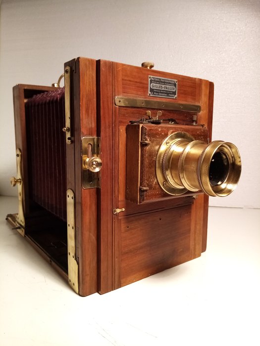

Hello Ian,
The first who made (with patent) holders like these in France was, in the 1860s,GILLES Frères, later (~1900) named GIILES-FALLER, until the 1970s. I have a camera from 1870 (Giilles Frères) and another from 1970 (Gilles-Faller), they can use the same holder.
Here is one there, on the second pic : https://www.collection-appareils.fr...les-Faller_Chambre carrée mixte Huillard.html.
4 x 5 and 9 x 12 (cm) holders have the same external dimensions and the plate holders like yours were made until the 1950s ; earlier models are a bit different.
Later 13 x 18 cm Gilles-Faller Sheet film holders fit also 5 x 7 film without problem, I often used them like that.
After GILLES Frères, many manfacturers made copies of these holders in France ; it's not sure yours are from Gilles-Faller...

Here are 2 holders. The older is on top,
the later like yours below.
The rear of a Gilles-Faller (~1950) with the ground glass on :
and with the older plate holder :

The identification plate is used to date the camera.
This 18 x 24 Gilles-Faller was my first large format camera.
I bought and used it in the (19)70s.
I was young and not afraid of the high weight of the device ; it didn’t last...
It was replaced by a lighter 13 x 18 G-F I used a lot.
