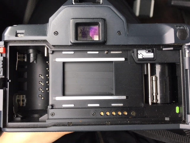

@John Rereading this and not sure if I understood the part you referred to. This is what the inside of the camera looks like. Is there something I can test or check here? Vs. the rewind button on the outside of the camera, which is what I had tried previously.

I see some detritus on the contacts near the bottom. Try gently cleaning there and any other similar contacts with a soft cloth and something like a toothpick.

Auto load cameras have sensors under the take up and if blocked with debris the camera will not load film. Blow out the takeup chamber with canned air being careful not to shake the canned air can while in use.
The contacts along the bottom are for the data back.

Many autoload 35s have an infrared photoemitter-photosensor pair that counts sprocket holes when the film advances. There could be something blocking that infrared light path, or the electronics could have failed and the camera is now a brick. :-(
