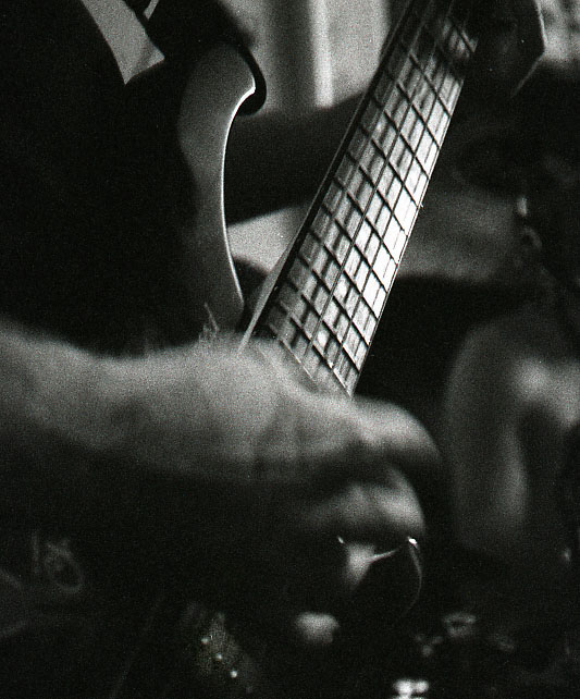

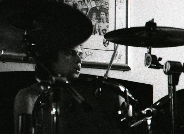

Did the gig last night. Turned out to be a small local pub in Norwich which lets young up and coming bands strut their stuff.
The band were very good and have a lot of potential.
Photographically the gig venue was terrible. The place was very small, the lighting was almost non-existant except a pair of small wall lamps. And yes they were behind the band.
I used Delta 3200 rated at 6400, with everything on the camera switched to manual. Most shots were at 1/20 or 1/30th. It was clear that fast lenses would be a bonus if you did this stuff often.
I developed in Rodinal (All I had available last night) for 20 mins @20c as per the dev database. Nice grainy negs :smile:
Here are a couple of examples
Phill
Mar 23, 2006
858
Hello Phill,
Nice shots . . . like the close in on the guitar. Definitely fast lenses make everything easier, especially focus on an SLR. I notice you are using Rodinal, but have you tried Ilfotec DD-X with Delta 3200? I was getting better results with that than other developers; might be something to try out.
