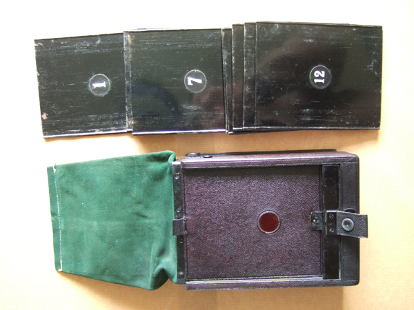

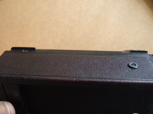

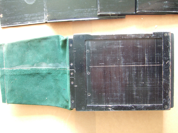

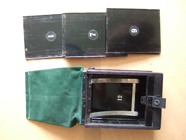

Picked up out of curiosity at yesterday's flea market.
There is no identification except 'Made in England' and 'R8' stamped on the holder. It is made to hold 12 5x4 glass plates or 12 5x4 sheet films in idividual holders numbered 1 to 12. The numbers can be seen through the ruby window on the magazine. The holders supplied with this example were for plates but a switch on the magazine can be set for plates or film so I assume film holders must have been available too.
Pulling the tambour slatted cover across the holder does the equivalent job of pulling the darkslide in making the plate ready for exposure. Once exposed, pushing the cover back ejects the exposed plate into the green suede pouch at the end of the magazine. The next plate is then automatically placed in readiness for the next exposure when the whole process will be repeated.
The edges of the holder are a bit like the fast loading design used on Thornton Pickard plate holders in that the flange along the edge of the holder is only partial, allowing for faster attachment and removal.
I can only guess that this is most likely from a Marion, Houghton or Thornton Pickard camera being English made. It is probably later in that there is an option for film or plate and the fact that it is for 5x4 rather than half plate or quarter plate.
An ingenious and nicely made item but a mystery.

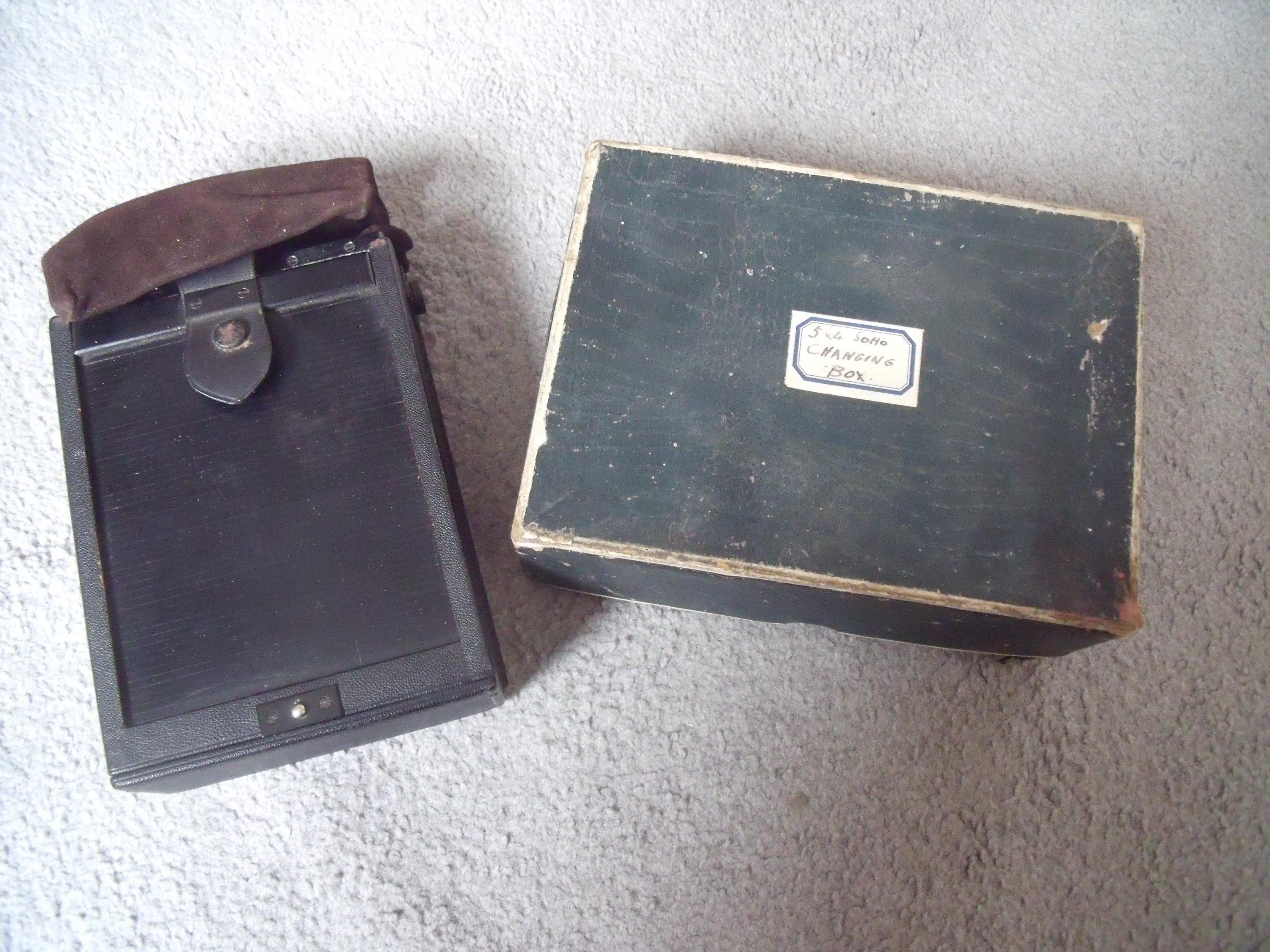

Steve, I have what appears to be what you're looking for, found amongst my late father's belongings. (He was a photographer). No manufacturer's name on it. The only clue is what's written on the label on the box lid - 5x4 soho changing box.
Interested?
Peter

Thanks for the information on A. Adams Ian. My BJPAs only go back to 1930 but there is an entry here for both an Automatic Changing Magazine and a Bag Changing Box of which the latter is quite similar to that used on the Soho. The Changing Box that I have has a switch on the side which can be set to film or plate. This has the effect of widening or narrowing the slit through which the exposed film is fed back through into the box to the back of the stack.
I do have a load of old MPP film holders that have removable 5x4 film inserts so I may try half a dozen of these to see how I get on.

Hi Steve. I can't tell what's inside as I can't open it. Something seems to be jammed. There's a little knob on the side which allows you to select film or plate. This turns ok. I suspect that corrosion in some form has taken its toll. I don't want to try taking it apart in case I mess it up. There are no markings on the box.
Peter

Hi Peter,
In the position that you have it pictured, the cover that removes to allow you to remove the plates is itself covered by the roller blind. If you turn the box over you should be able to see inside it. If there are plate holders in there you will see either a flat black metal surface or an opaque glass (if a plate is loaded) or flat film surface (if film is loaded. If you apply pressure to this surface it will depress and spring back when you release it.
The roller blind on the surface we can see in the picture should pull back across the face of the back revealing a cover with a ruby window in. My guess if it ijammed is that a plate is partially stuck in the exit hole that is used to eject it into the suede bag. You may be able to feel this and push it back.
Either way, what do you want for the holder in it's current state? I may be up for a gamble!!
