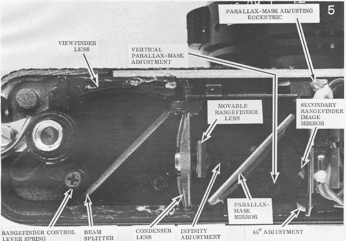

I still have the lens, but I don't understand how it attaches. In the picture below you can see that it is larger than the holder, but in the manual image it looks like it's the same size.

The lens element looks as if it presses into the frame from the back side. Center it on the frame, hold the frame very stable, maybe a thin wood or carboard on the front side, and push the lens?
The video shows a basic cam adjustment in action. And this cam adjuster is sitting on top of the rangefinder cam arm. The rangefinder cam arm is what reacts to the lens moving in and out, moving this lens which causes the viewfinder image to move. The cam motion is for centering the lens. It may be related to basic centering or may be related to setting infinity, I don't know.

I'm 99% sure you have the lens backwards but I'd need to pull a camera out of the depths of my storage to check. Why have you removed the condenser lens?
I removed the condenser lens so I can have easier access to the small lens.
Yes, I do think it's backwards in the shot, at least according to the picture in the manual.
I'll try to snap it in like the first comment said, but I'd be surprised if it works, the lens seems much bigger than the frame. Maybe it's glued in place? I couldn't see any glue residue

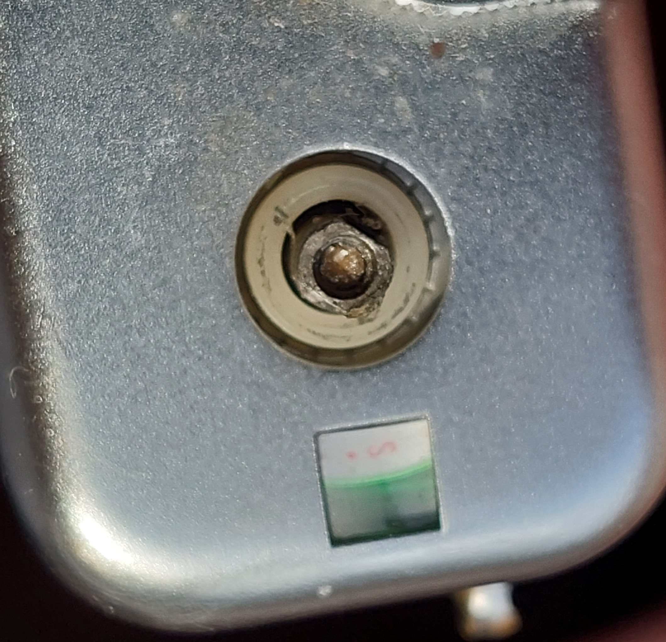

I ended up gluing it in place but as if my luck wasn't good enough, the screw broke in the advance lever and now I can't put it back together. Oh well, at least I learned something

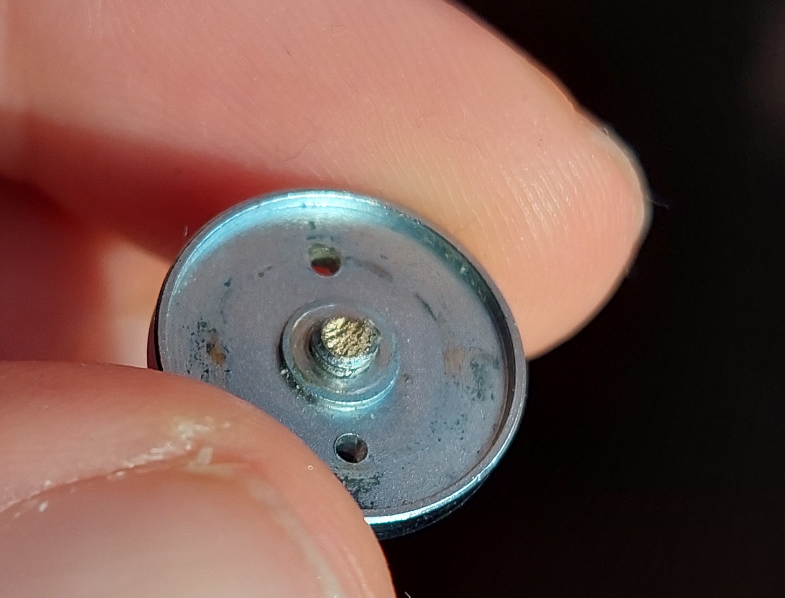

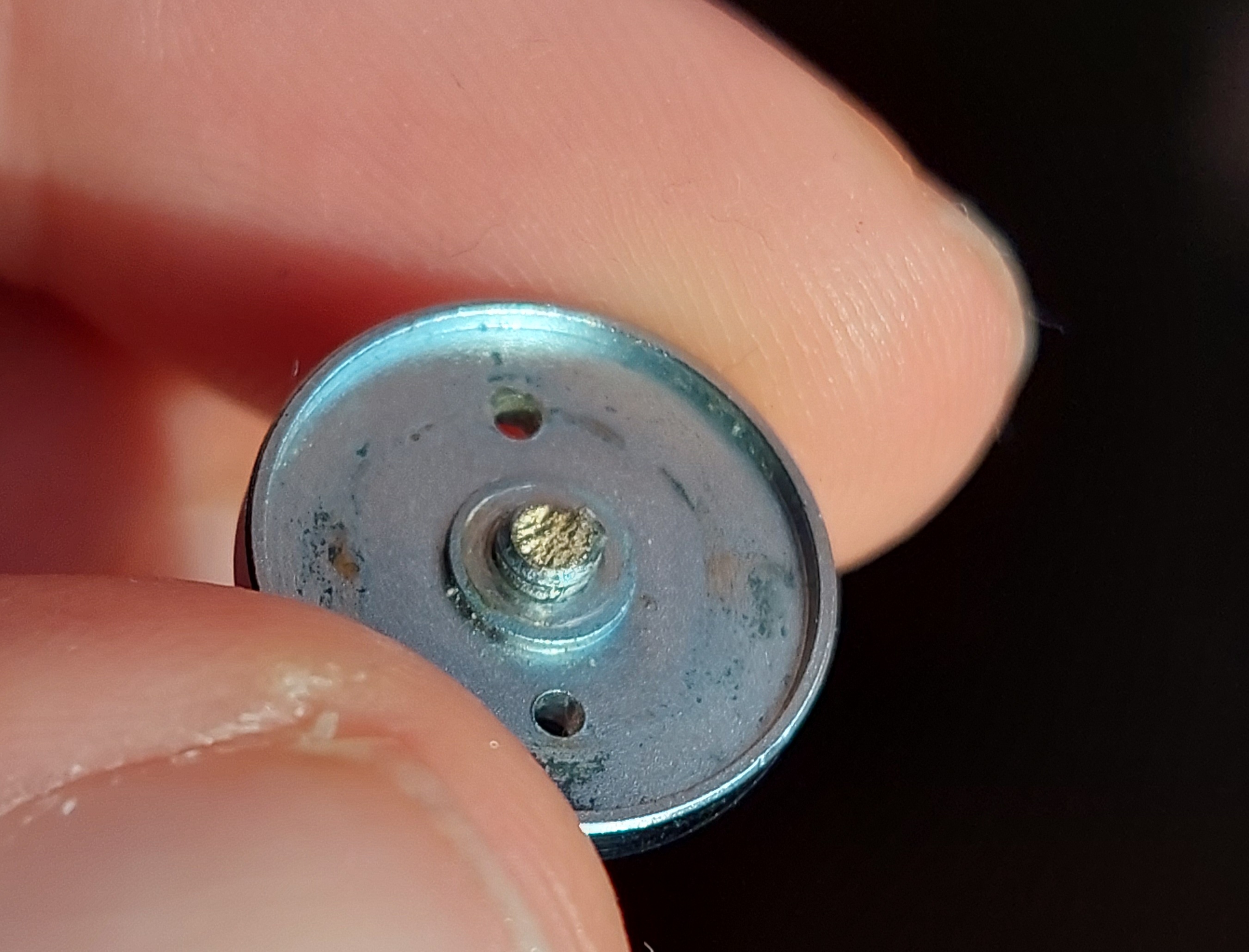

I didn't post because I don't think it's salvageable. Here's the pictures. Looks like screw attached to the endcap of the advance lever broke inside the camera, so now it's not possible to screw it.
