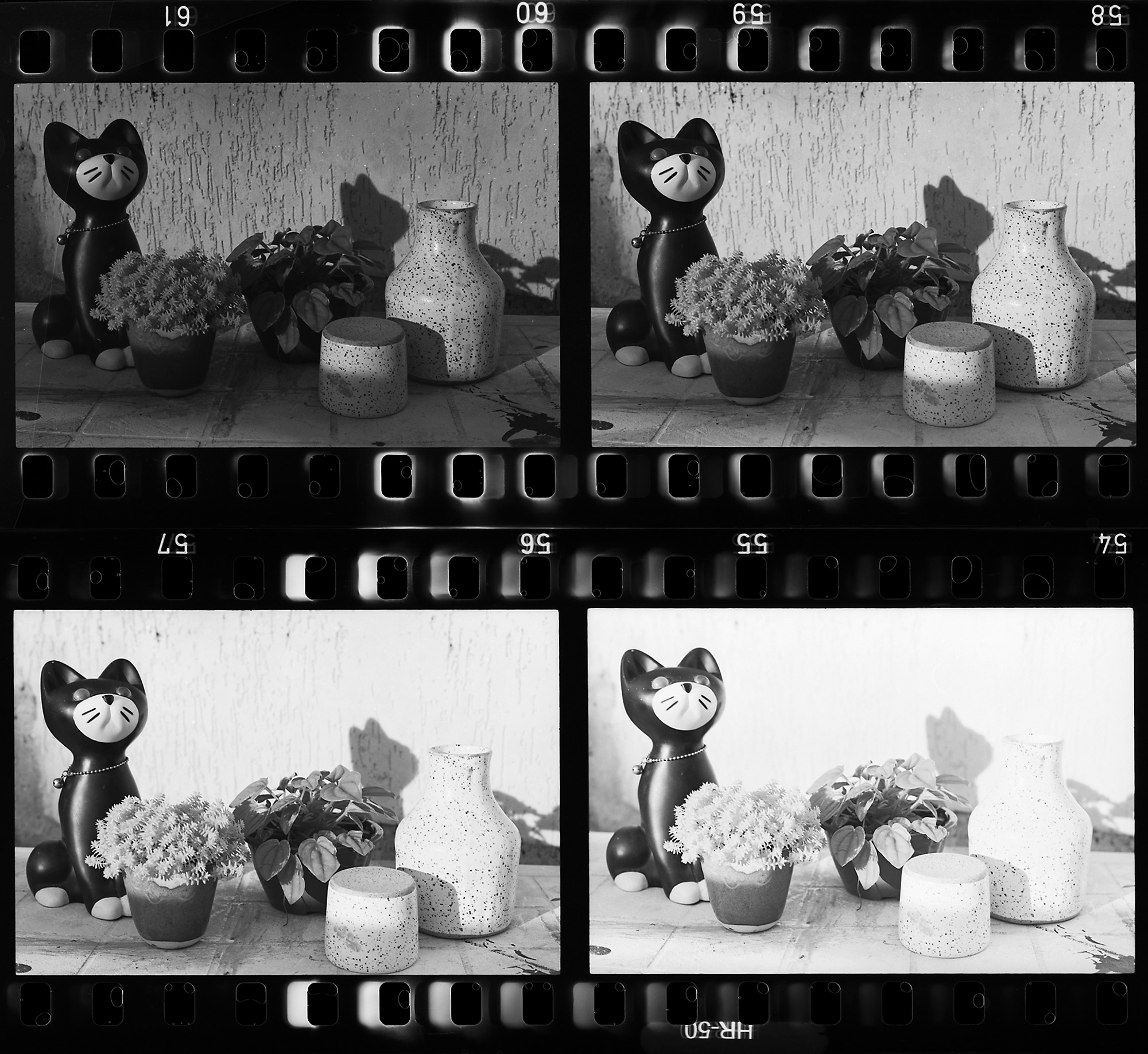

Here we go... The four exposures are bracketed -2, -1, 0 and +1. Like I said before, developed with Acufine for 4.5 (or 4 1/2) minutes at 20 degrees Celsius. I have shot a +2 exposure, but it's way too bright.
I can say, for sure, it's overdeveloped. I guess 4 minutes would be better, maybe even 3:45. The exposure at ISO 50 (full box speed) looks too bright and contrasty. The exposure at -1 (ISO 100) looks fair, maybe half a stop too dark and a still a little too contrasty.
The problem, for me, is working with these extremely short development times. Has anyone here tried diluted Acufine? What does it do to grain?
