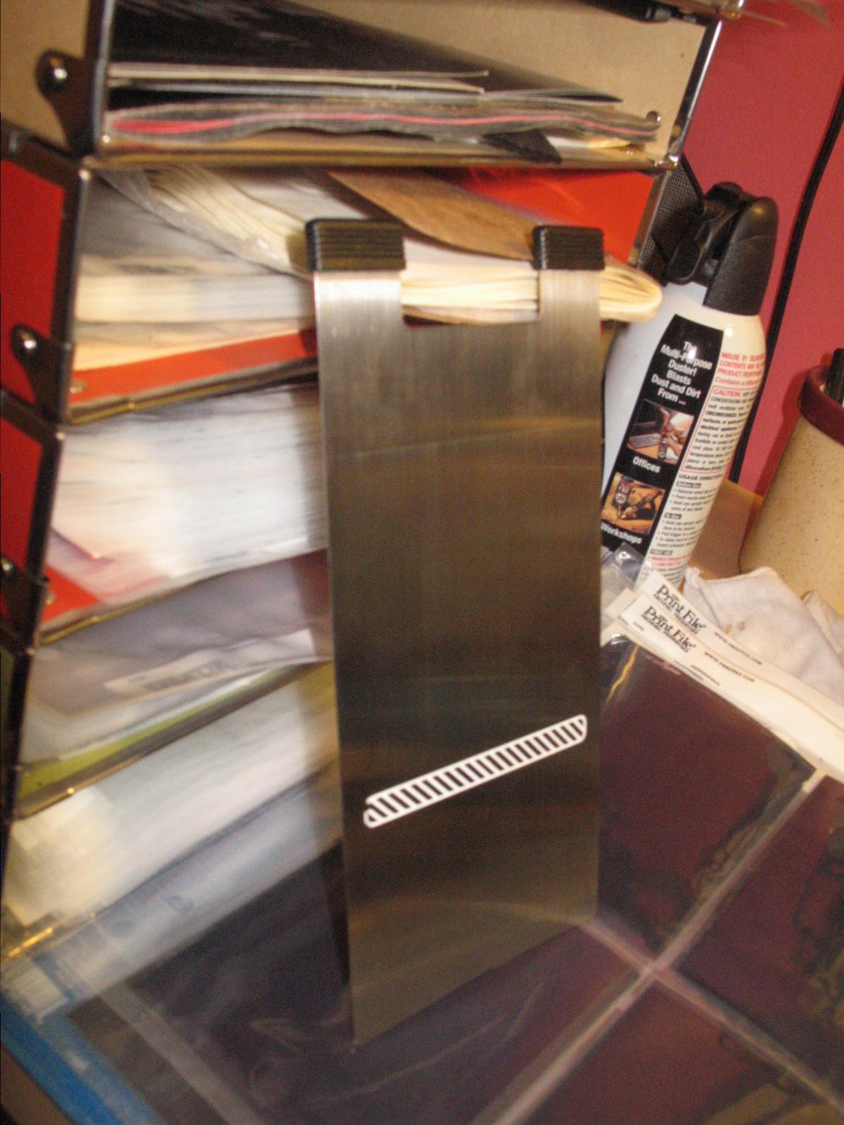

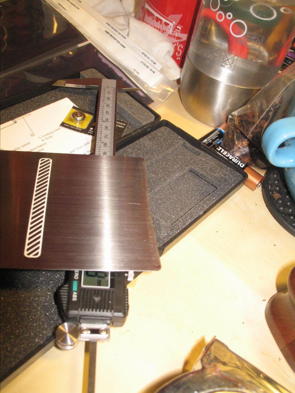

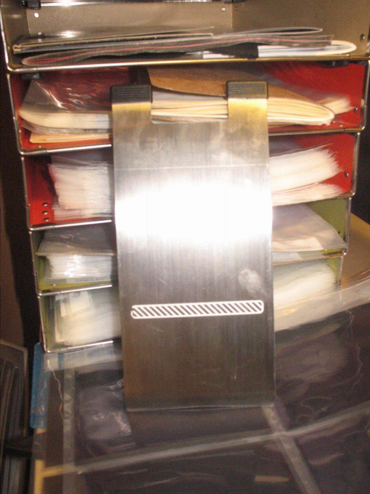

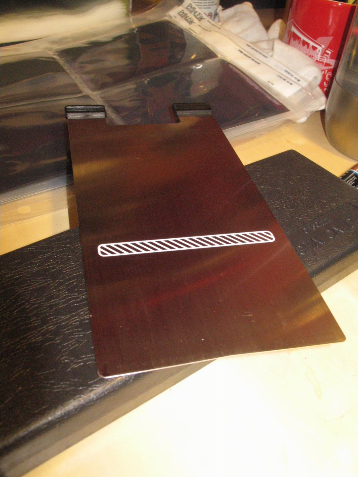

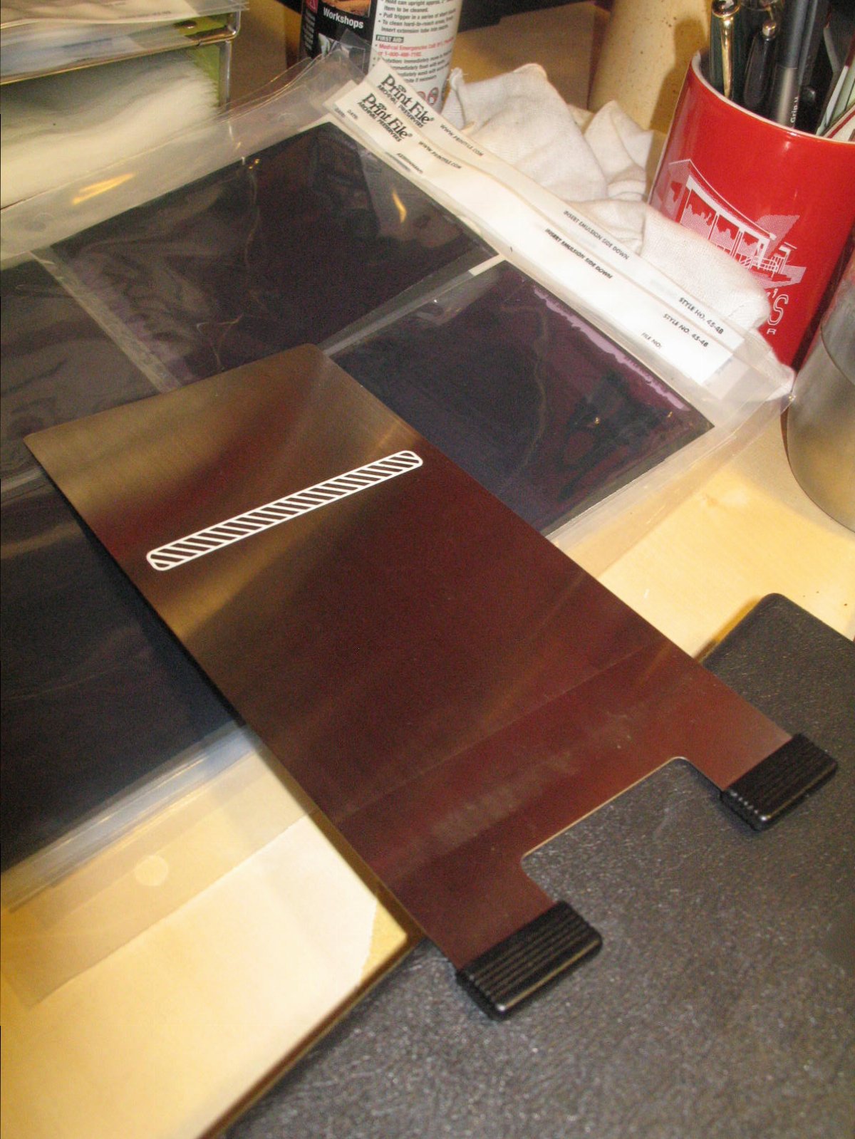

here ya go:
width along full lenght 4"
lenght from center of cut out to end of slide at apex of V:
7 3/8"
depth of V:
1/8"
lenght from black pull handle to end of slide:
8.5"
thickness:
.01645"

Thanks!
David, thats just excellent - thank you.:D
atlcruiser
Dec 26, 2009
102
Just remembered that is the fuji darkslide but it should be the same
