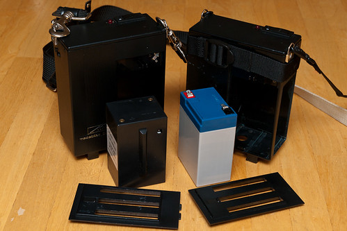

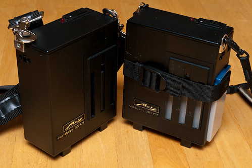

About battery replacement for the Metz 60....
I already have a Metz 60 power pack with a Li-Ion battery. I later bought a spare (no battery) for $2.50. Since it is only a back up, and I'm cheap, I didn't want to spend $80 for a new replacement battery. An SLA battery with the same voltage and capacity, only different in size, is only less than $10.
So I decided to mutilate the power pack to contain the $10 SLA battery. It's on the right in the photos below.

This is good to know. Thank you for the information. I had to eventually replace the battery and managed to get a dry fit cell from Metz U.K that has now lasted 3 years but it did cost £50 ( about $80). What about charging the SLA (standard lead acid?) battery, I assume with the Metz charger?,
Yes, I charge the $10 SLA battery with the supplied Metz charger, with the lug set to "Dry-Fit." As stated, the $10 battery has the same chemical (SLA), voltage (6V), and capacity (4.5 Ah). The only difference is the dimension.
This is the battery I bought.
I bought the Li-Ion battery from here. If you're interested, you may want to drop them a message asking about shipping to where you are.
The Li-Ion is 1 lb lighter than its SLA counterpart, has more capacity. For what I can measure, recycle time is shorter (about 4.5 sec vs. 6.5 sec). I just have it for a few months so I can't tell about its longevity.
