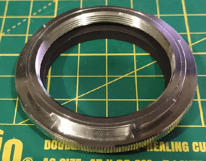

Help please identifying an adapter.

This side is female threaded M44, and the outer bayonet is 50mm

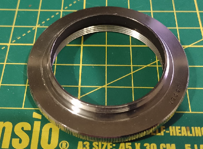

The rear has male M44 thread. The only marking is Japan, and a flat spot with a small red dot for alignment.
Ian
I found reference that M44 fits (at least some) Zeiss telescopes. The bayonet might be for a Miranda?
Some Miranda models also had a M44 thread and also a bayonet on the same camera! Odd I know but I had one way back in the 1970's. Actually Miranda's were quite nice cameras to use. I think they used lenses made under the Soligor name, but I only had a prime 50mm F1.9 with the bayonet fitting. The others were Soligor with a interchangeable thread mount, usually called a T2 with a manual stop down ring
Looks like M42 to Miranda.
Very definitely not M42, it's larger, I tried an M42 lens, it's M44.
Usually the male part of camera lens flanges have 3 projecting edges that fit a corresponding Bayonet female mount, or breech lock. This adapter has 4 projecting edges to the flange.
Ian
The Miranda flange was different I know but cannot remember the exact reason. 3 flanges on a bayonet mount were common place, maybe they chose 4 to get around possible design patent Infringements. After all the there was also the 44mm thread to take into account.
The Miranda series of 35mm SLR cameras featured a unique lens mount that incorporated a 4-claw bayonet, as well as a 44mm screw mount for compatibility with older lenses.

From the male screw thread, (all screw mount lenses I know have male threads on the lens) I suspect the 4 prong section may be from a breech lock system rather than a bayonet one. I've not yet gathered much info on breech systems.
I've known cheap screw together extension tubes to have a wide variety of threads in seemingly random orientation but these all seem to have much finer pitched threads than this adapter.

Thanks, now I know it's a Miranda AU Adapter.
