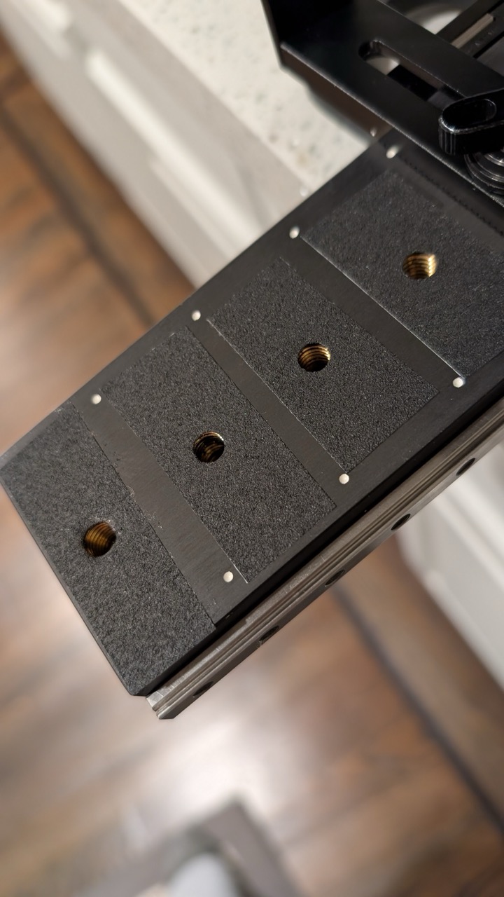

I have Chamonix F1, and kinda guess what the OP's problem might be. The front standard is metal, and the bed is Carbon Fiber. So it is a bit slippery where the two meet, even when the screw is tightened. I have a simple solution that cost less than $0.02: just add strips of rough surface gaffer tape right on the bed and along each slot that front standard will be in contact. And now once the front standard is locked, it will not shift in any direction. Better explain with a photo below.
