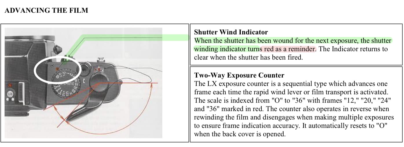

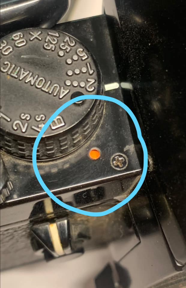

A Pentax LX came in to my hands not long ago, overall looking good, lightmeter works. The only problem it is winded but the shutter won't release (lock is unlocked).
Shutter winding indicator is red which means it is winded.

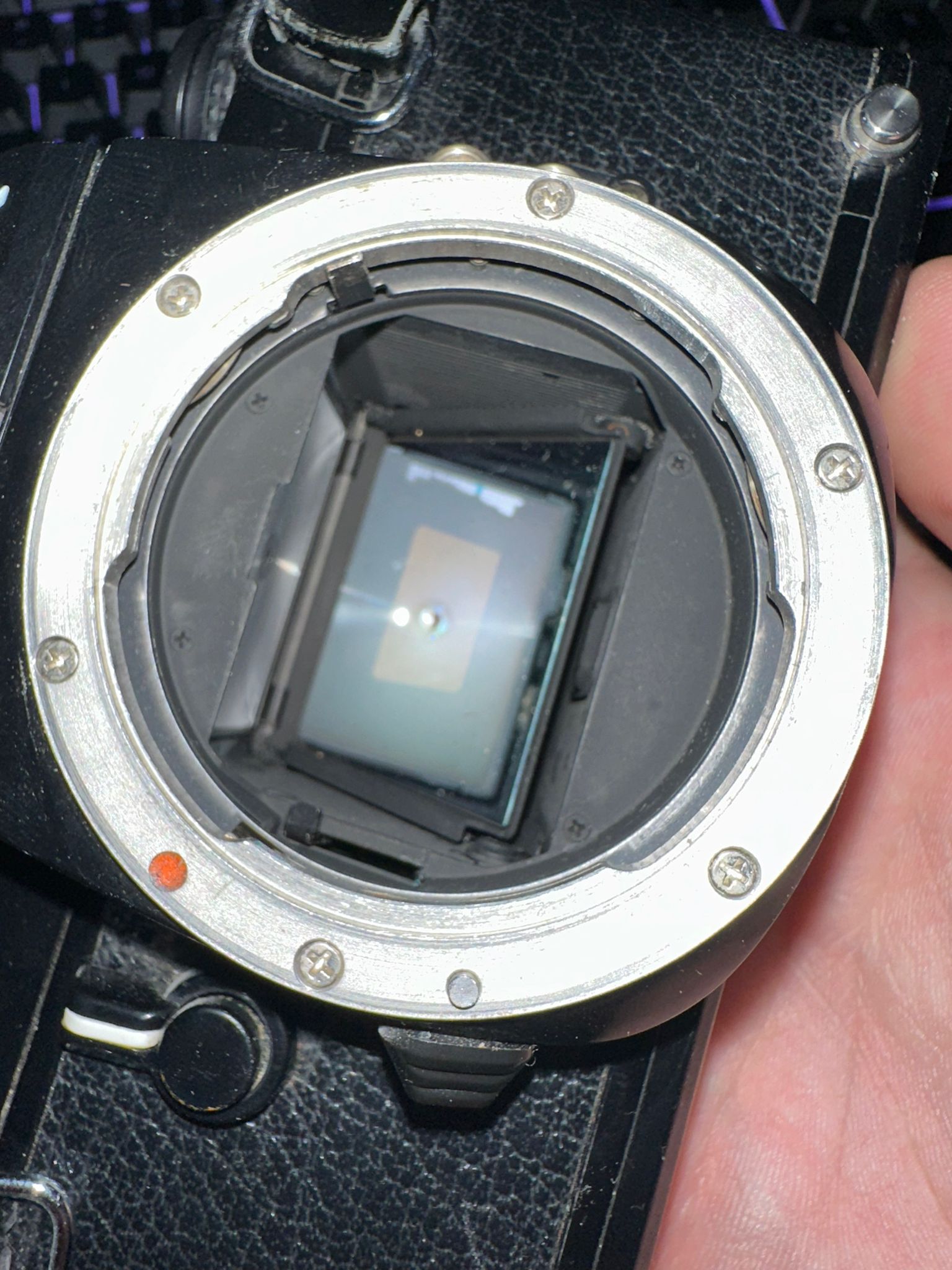

**EDIT** : mirror is down, no sign for sticky mirror syndrome.

Have you checked if the mirror came down after the shot?
The Pentax LX is notorious for suffering from the Sticky Mirror Syndrome.
This is due to the foam damping material which degrades over (long-) time and sticks the mirror up against the Ground Glass frame.
This is a costly repair IF the parts, the tools and the knowledge needed are still available...
Don't forse the camera to work as more damage may be done!!!!!!!
Once repaired, the LX is one of the best 35mm camera's, I had three of them.

The mirror is down, I'll edit now in the first message.
only problem i observe is that the shutter is not releasing... :sad:
I really hope to get it working.

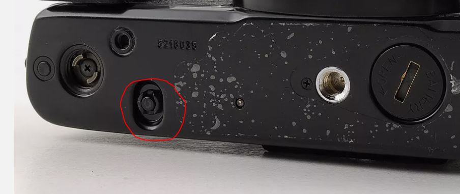

OK then , but there are foam coated rests on which the mirror rests when down...
Carefully check if the mirror can move upwards by carefully moving it manually.
BTW, is the rewinding mechanism button disengaged?
This mechanism lets the counter turning (counting) backwards so you can return to the initial frame after taking out the partially exposed and rewinded film to put in an other film, or double exposures.
reysphotofilm
Aug 15, 2024
11
Europe
Mirror moves freely.
where is that button?

The rubber bumpers that degrade are inside the camera, on the side of the mirror box. Sometimes it just slows the mirror down and it lags the shutter press. If it gets really bad, it will seize the mirror, which is my guess as to why yours won't fire.
The rubber pads on the mirror rest can get sticky but they usually won't have enough adhesion to completely hold the mirror.
