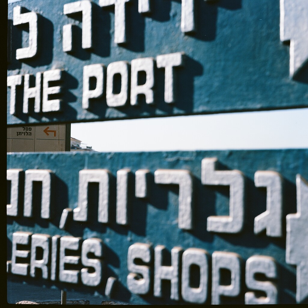

So. I've been using my Isolette I for quite some time now, and I love it. Really, Really love it.
one thing I can't seem to get the hang of, is how I should address the parallax error.
How do you develope a hunch for it? How can I train myself to succesfuly compensate this issue and get a better control over close ups?
Attached a wonderfull image, which was undercompensated and ruined for the most dreaded Paralax Error! the gap inside the sign was suposed to be showing a beautifuly placed skyline of Jaffa.
Thanks!

If the viewfinder is (say) an inch above the centre of the lens, frame the shot and raise the camera one inch - easier if on a tripod.
Thanks!
You almost always end up guessing. the tripod trick is your best bet. Mamiya even made a device for its TLR cameras that allowed you to frame with the viewing lens, then raise the camera precisely the distance of lens separation before shooting.
but perhaps you might also consider the fact that there are some shots best done with through the lens viewing via an slr.
ic-racer
Feb 25, 2007
16,680
USA
Someone should invent a camera that lets one compose through the taking lens....
gone
Jun 14, 2009
5,504
gone
Those Isolettes are wonderful shooters. The only thing I can say is that after a while (and after a lot of missed shots) you get a feel for this. It's different on every camera too.
OptiKen
Oct 31, 2013
1,055
Orange County
.....and different at every distance
Bill Burk
Feb 9, 2010
9,440
That is really a funny shot.
I say that because it reminds me of a shot that I once made at a mission with an OM-1 because I "knew" it would prove without a doubt that an SLR was superior to a rangefinder.
I lined up a cross at a distant graveyard through a fencepost of the outer mission wall. Any parallax would have caused the cross to vanish.
But it was a dumb idea in my case, the picture felt forced, and it wasn't successful.
Your shot had a better chance of being interesting had you pulled it off...
tal bedrack
Nov 19, 2012
17
Israel
Practice does it :smile:

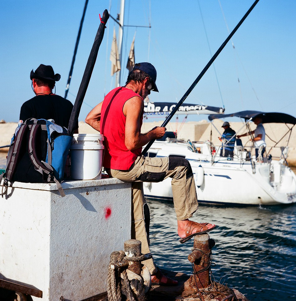

I'm somewhat of a control freak and SLRs meet my preferences perfectly. I appriciate a well composed
picture and have trouble letting go of the precision involved in framing a shot. But I sure love my
Isoette. Well, guess I'll have to fine tune to a rangefinder style of shooting and composing.
Here's a shot from the same roll that came out as expected.
