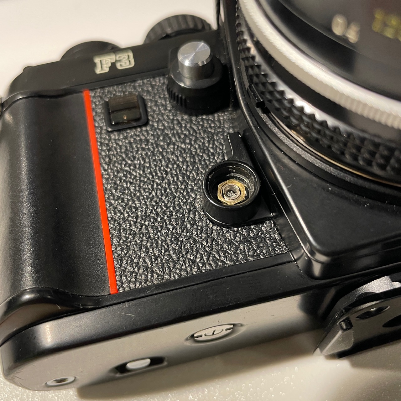

A couple weeks ago I purchased a Nikon F3. The overall condition is very good, but the memory lock button was lost. I found a 3D-model here, asked a friend to print it with ASA and it seemed to be alright so I installed it. It clicked in altough it seemed a bit crooked... but ok for now.
On the first test run I noticed the suggested exposure display did not change properly: no matter what shutter speed I dialed in / no matter how far I opened that lens there was a minus on the screen. I assumed this must be an issue caused by the new button as the camera worked just fine before.
That's when I tried to pull out the button until the head fell off. The shaft remained stuck. I already tried a couple of things to remove the remaining part of the button. E.g. used tweezers to grab it, disassembled the mechanical shutter lever and tried it again. I had no success as it is firmly stuck and barely any material to grab.
I have to say, the exposure works again on the small lcd display (I get the minus / plus / both again) since demolishing the fake button. So the easiest would be to just leave that damn thing were it is. But I'm not happy with that solution.
I'm no fine mechanic, so I'm not gonna tear that lovely camera apart without help.
Does anyone know how to get that shaft ouf of the memory-lock-button-hole? I guess I have to remove the front cover... but that's the only cover I haven't found a video removing it.
Thanks in advance - any help is appreciated!

Just wanted to show the mess. It's not too bad, just ugly for such a great camera.
Like @BrianShaw said: the functionality is still ok, wouldn't have used this feature very often anyways.

I tried to get it out for 1,5 hours now. I actually managed to get 6-8 mm of the shaft out. Unfortunately, it broke way down in the hole and the rest is stuck again blocking the memory function.
I guess this is the point to open the front cover…
I have to remove the leather in order to access the screws, right? Can I reuse the leather patches?

IMO, you need a pick to winkle it out. This is a pointy steel tool like a dentist's pick or scraper. Failing that a needle might work, but the pick has a better handle.

I tried it with a needle and actually can reach the shaft and bend it just a little bit. Enough to trigger the memory button on and off. So function would be ok for now (don't know how long this works).
The problem is I obviously can't grab with the needle… even if i managed to break that leftover shaft it would be in there potentially causing the next error.
All that picking already caused the next error: The manual shutter lever is quite loose now. There is some resistance for the actual shutter, like the last 10-20 degrees of the rotation, but the initial motion is loose. The lever moves when tilting the camera.
Any screw to tighten other than the nut holding the lever?
