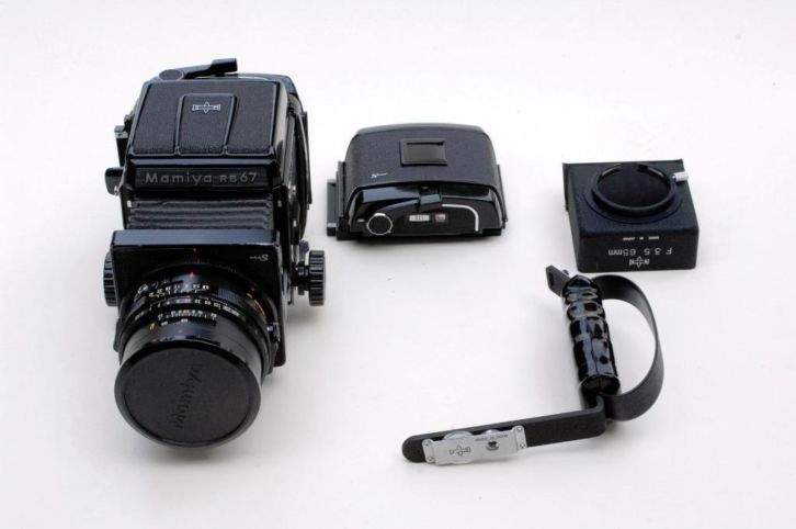

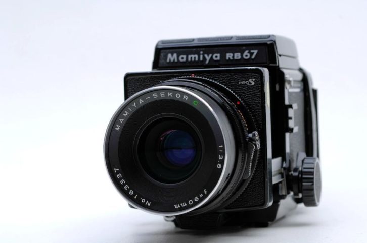

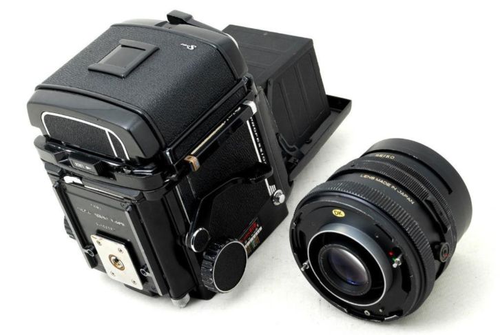

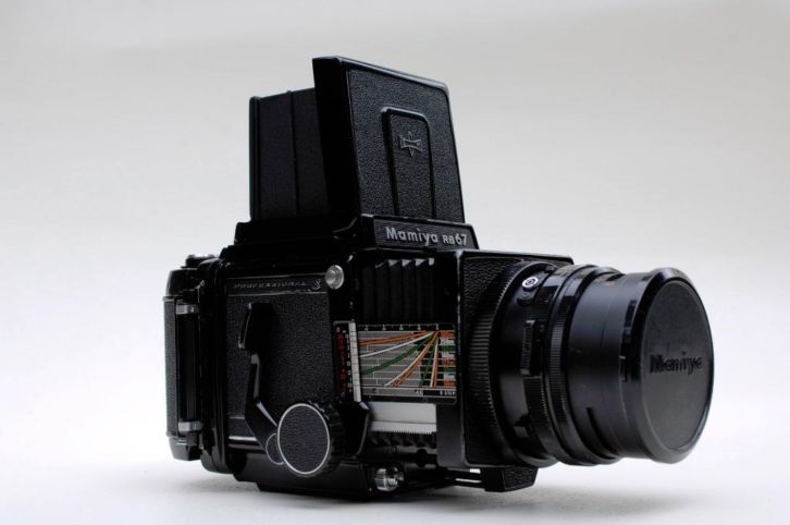

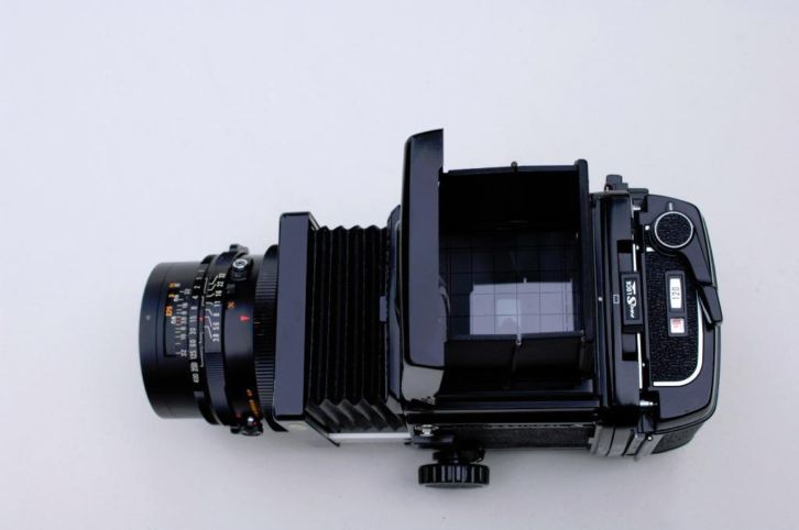

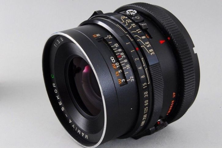

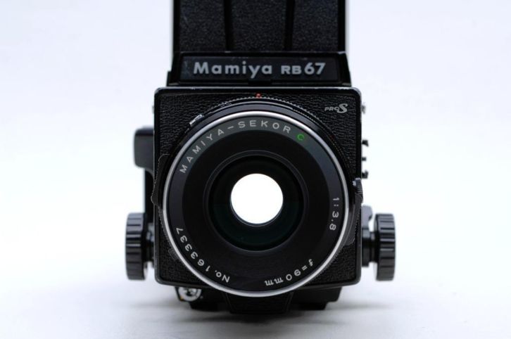

Hi,
I'm offered a RB67 for EUR200. It's not too far from my home so I can drive over and see the camera before buying. I'm familiar with MF cameras (Bronica SQ-B, RF645, Rollei SL66) and would like to have a RB67 also. (I don't need it, GAS, ... I know, but I will use it - promise!).
Since I'm unfamiliar with the RB67 models, haven't even hold one yet. So my question is:
- it this the right model RB67 to look for?
- what are the problems/quirks to look for in this camera to access if it is a decent working camera?
- I'm guessing this price is a decent price? €200 is about $260.
The set is offered as:
- body RB67 (model Professional S ??)
- 90 mm lens: Mamiya Sekor 1:3.8
- 2 film holders 120 type
- grip
- 2 dark slides
(BTW: The images also show a lens hood)
These are the images from the ad:

any of the RB are ok
check the light seals in backs, adapter and mirror are ok

The Pro-S is a good choice - the camera plus matching backs gives you all the safety interlocks you need.
If it is in good shape, $260 USD is a good deal here. I cannot say what a good price would be in Holland.
I carry mine regularly. It is big and heavy, but certainly usable. Try it with a monopod - the rotating back makes it very functional.

An RB67 like that was my "return to film" camera last year. Really love it.
Everything in the photos looks "right". When you inspect it, just verify that everything functions smoothly.
If the seals haven't been previously replaced, odds are you'll want to do that. I did it myself on mine. Its not a hard job, and the kit won't cost much. Unless the current seals are totally shot (meaning you can tell just by looking at them that there is no way they are good), you won't really know until you run some film through it.
