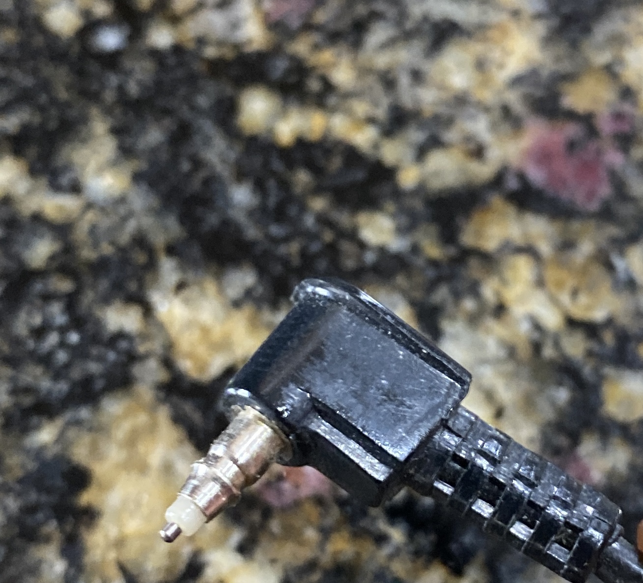

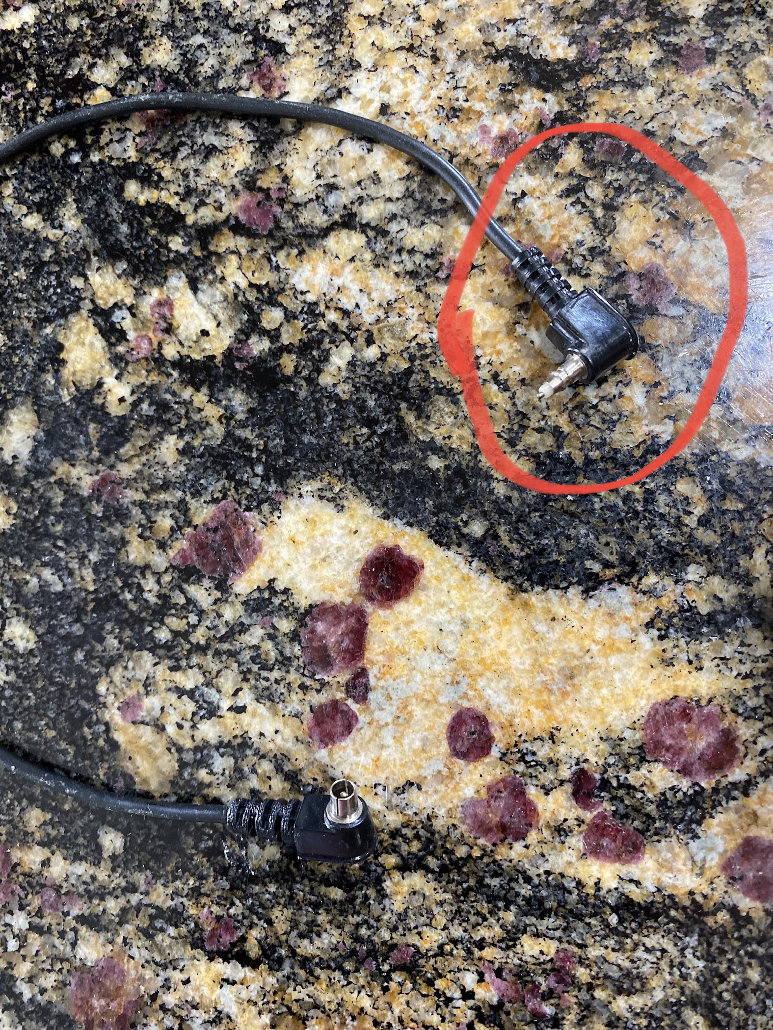

Hello. I’m looking for someone who can tell me the name of this sync cable. The end circled is what I need the name of. That end fits perfectly into my Minolta flash. I just need another cable that has the opposite in with a 2.5mm jack instead of the pc sync.
Thanks for any help.

The connector itself is not proprietary in the meaning of unique.
But the world of synch-connectors is a world apart...
A manufacturer of synch-cords labelled this model of connector as "Vivitar".
I got quite a collection of synch cords but have not yet come across the combo being looked for.
But at that manufacturer it is available for only 85$.

Thanks for the info. I’ll try searching Vivitar & see if I come up with anything. I’ve been shooting a lot lately with the Mint Instantkon RF70 and it only has a headphone jack to sync a external flash. I’m starting to think that I may have to get someone to splice the 2.5mm headphone jack onto my existing cable.

Exactly!
You got options:
-) replace te the current PC connector by a 2.5mm one
-) use a male-PC/2.5mm cord as intermediate
-) open your flash, take out the connector amd install instead a piece of cable hanging out with at its end a female PC connector, making your flash universal again

I use for my Minolta flash a PC cord - hotshoe adapter (on a Minolta Autocord), since I also didn't have this cable: https://www.bhphotovideo.com/c/product/1130423-REG/impact_scs_mpc_male_pc_to.html . I use it together with a L-bracket... This of course might or not might work with your setup, just want to show another option.
But yeah, I would have liked to have as well a standard PC connector then this thing (which seems to be Vivitar style, as pointed out above). I have a few Minolta off-camera cables ("cable OC"), which are 4-pin cables for TTL flashes like the 360PX, but this doesn't help when you need PC...

Yes, both the classic hot-shoe/PC adapter and a PC/2.5 adapter combined is a good no-tinkering approach as both items may be more common than anything with a Vivitar-connector,

Solder and heat shrink tubing = "about any cable you could want". Watch a couple youtube soldering videos, got a couple extra connectors to practice on. It's really pretty simple stuff.

For a Vivitar to 3.5mm cord, that's a stock item, for example this at B&H: https://www.bhphotovideo.com/c/product/1402034-REG/nisha_fsc1635v_16_flash_sync_cord.html/?ap=y&ap=y&smp=y&smp=y&lsft=BI:514&gclid=Cj0KCQjw1N2TBhCOARIsAGVHQc7QJYfsZYPtb2Qb2EJykxzKY3OFtmjHc0Nt9-de6k1z3H5Xzrf3vPkaAmuREALw_wcB
or just search "Vivitar 1/8 flash cord."
If you need a 2.5mm plug, you may be able to use that cord and a 3.5mm to 2.5mm adapter. However, most of those adapters are for stereo headphones so they have extra contacts and you'll have to be sure that your tip and sleeve are making the right contacts.
