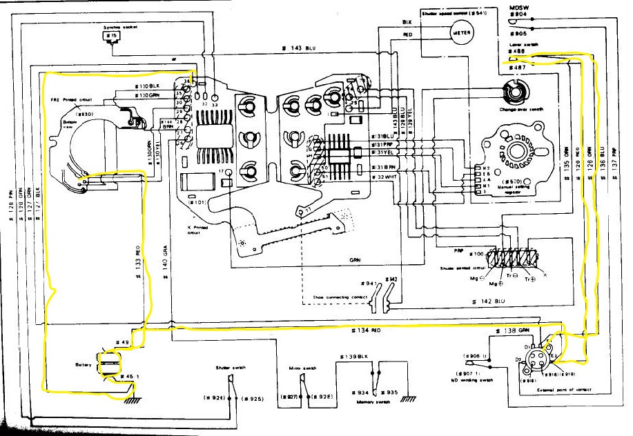

Download the service manual at https://learncamerarepair.com/product.php?product=253&category=2&secondary=8
The battery wiring is highlighted in yellow on this copy of the wiring diagram.
