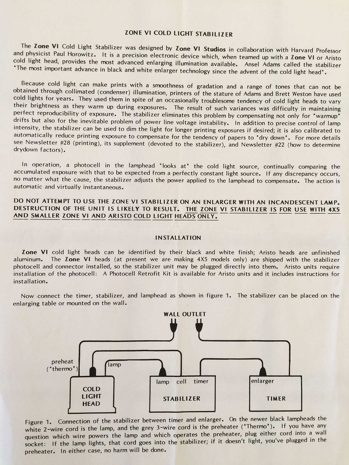

After doing a couple of hours of research and reading, I think I understand how to use this cold light (never used one before on any enlarger). Just wanted to run a few things by the experts to make sure I'm not getting this wrong.
  1. Heater cord from the cold light should be plugged directly into current, while the lamp cord should be plugged into the timer, which should in turn be plugged into the stabilizer, which itself is plugged directly into the wall. In addition, the 3-pin cord needs to plug directly from the stabilizer into the cold head. Is this correct?
  2. It is normal for the stabilizer to indicate green light up until roughly 1/3 of the way up the intensity scale, when it goes over to red "unstable" indicator, and I should be using the intensity slightly backed off from the highest point at which it will give me green?

Alan9940
Jun 17, 2006
2,491
Arizona
Wow, what a deal!
How 'bout I just provide you with the instructions... :wink:

Now that works. Thanks!
