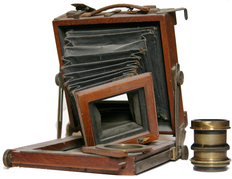

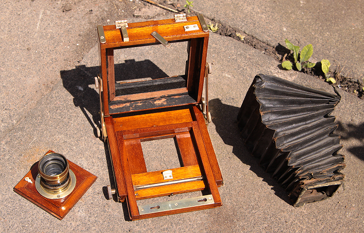

I've had a Quarter plate camera for years that an ex girl-friend gave me in the early 90's. It's sat on the mantle piece until last night when I decoded restoration was in order. The lens is in excellent optical shape andcovers 5x4 I have a TP shutter that can be used on the front.
Dead Link Removed
The initial restoration of the wood & brass was easy and took about 4 hours, the bellows are shot and will have to be replaced, and I'll have to make a new focus screen. The intention is to make a second back that will accept a roll film holder, or perhaps adapt a 9x12 Rollex (pre WWII Linhof fit) that I already have, but the register is significantly different.
The BIG problem is the front standard is missing, I have the lens board and panel that fits in & attaches to the bellows. I need some help, either if someone has some spare parts or photographs of what the standard might look like.

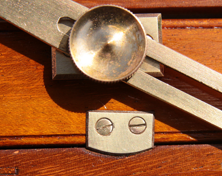

The other missing part is less critical and I need another beass piece, essentially a stop as shown below the thumb nut.
Any help/suggestions welcome.

you can pretty much guess what the front standard looks like. The 2 key holes in the nickel plate on the front of the camera "key" (lock) the front standard into place (2 screws stick out from the front standard and slide sideways to lock the lens board into place.
The lens board needs to be smaller than the back standard so that you can close the camera, but big enough to take the lens board...the thickness of it would be based on what timber you have available - I would guess around 8-12mm thick..

I can work out the size for the front standard as the camera is quite similar to this Half Plate Pembroke in the image below. It may even be made by the same company as the hardware is identical, there's some artistic license in the etching as the TP shutter is mounted sideways :D
Still hoping someone may have some parts which would save having to make the brass plate to adjust the rise/fall and getting the brass nob etc which are a bit like the fitting in the second image.

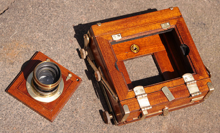

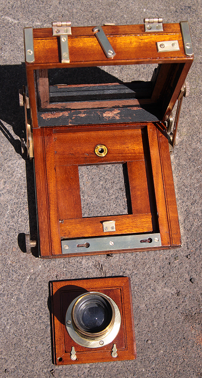

I totally dis-assembled the camera stripping off all the brass work, taking every screw out so all the wooden parts were separate, then I used wet & dry paper 400 grit. Finally I french polished the wood work, I cheated using a small paint brush giving 2- 3 light coats. The very bright sunlight when I took the photographs exaggerates the colour differences in the wood.
Ian
Now with a newly made front standard and a freshly ground new focus screen all that's needed is the new bellows, 3 brass fittings and a new top strap.
The camera will be used with a 6x7 roll film back on it's way from California courtesy of WadeD, so now to make an adapter to take this :D

If you look at the image of the similar Half plate there's only rise & fall on the front standard, the lens board is just sat high because with no lens attached it does :D
The standard has two screw which I filed to fit the key ways, them filed palt after fitting so there's a good fit between standard and focus bed.

There's a small amount of rear tilt, whether enough is another question.

Looking at the knob, I'm wondering if there is a captive nut in the front panel to lock it in place - If there is, don't suppose you'd know what thread it is ?
If this is a British made camera, I'd suspect it would either be a B.A. or a Whitworth.
There is a captive nut in the front panel, I've not found anything that fits so far. The camera's now in Turkey so I'm not sure how I'll check the thread, a small knob of a Bowens Monolight flash was very close, right size but wrong thread :D
I'll see what threaded bits I have on a couple of TP shutters and see if they fit, then ascertain what thread they are.

I have made another lens board and fitted a modern coated 105mm f3.5 Trinar, in a Compur shutter, it's cell focussing so I could focus the camera/lens at infinity on the ground glass and use the cells for focussing, it's hyper focal point is marked.

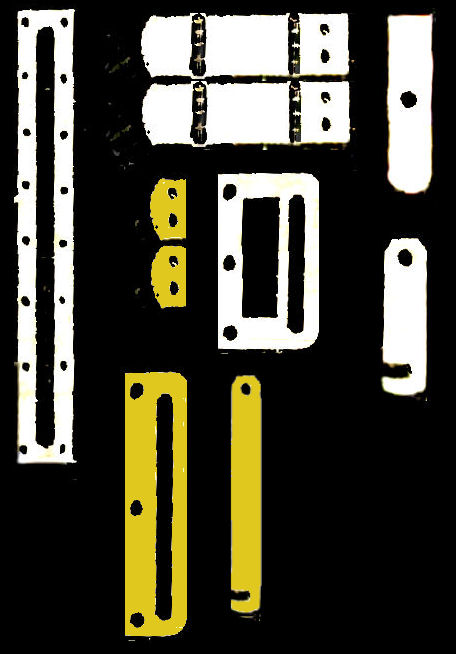

O.K. Will hold fire on posting these parts until then - Having done one set, I feel they would look better with a larger radius on the corners. 1.2mm looks out of place, so I may go for 3.2mm... Perhaps someone would like to comment ?
Just found two comprehensive lists and diagrams of Brass and Wooden parts available for camera builders in the 1890's I'll copy then in the next couple of days.
Every single part need to build a plate camera is listed, boxes, front standards, focus rails & gear, knobs, bellows etc. Just what we need today, I'll copy the pages in the next couple of days.

After looking at over 2,000 pages of camera adverts i found no identical Quarter plate cameras, however the details of the parts indicates that the brass work was similar to what was available from Lonsdale brothers of Leeds in the 1890's.
Based on that then perhaps the plate to adjust rise and fall might originally have had square corners on the standard side and quite rounded corners on the lens side, but as Londsdale Bro's parts aren't identical it's a guessing game. All missing parts to match Lonsdale's are in 2nd image coloured yellowish. (Not to scale)
