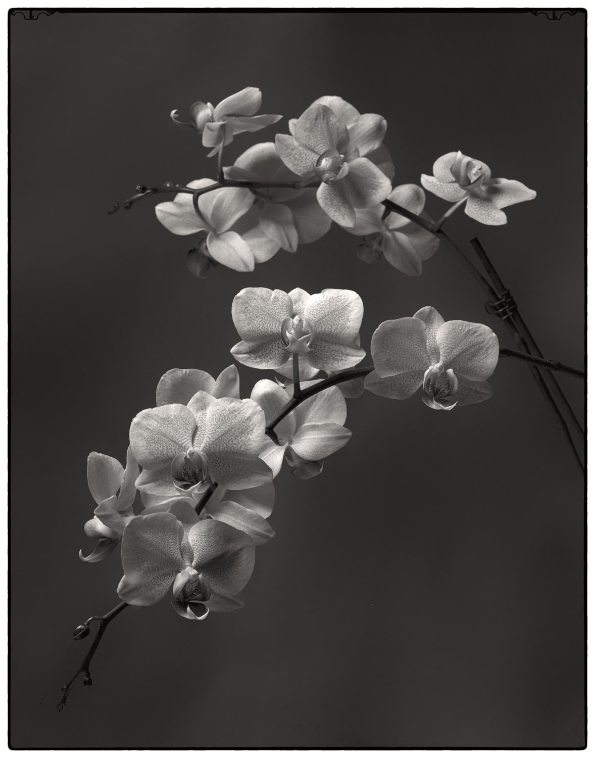

Here are test shots using unlblink eye dilution. 4x5 TMAX 400. Made simple tabletop setup with flowers, haven't come up with a better idea to test how highlights develop. On the first image background is black velvet, damn how good it soaks up the light :smile:
Looks successful from here... :wink:
