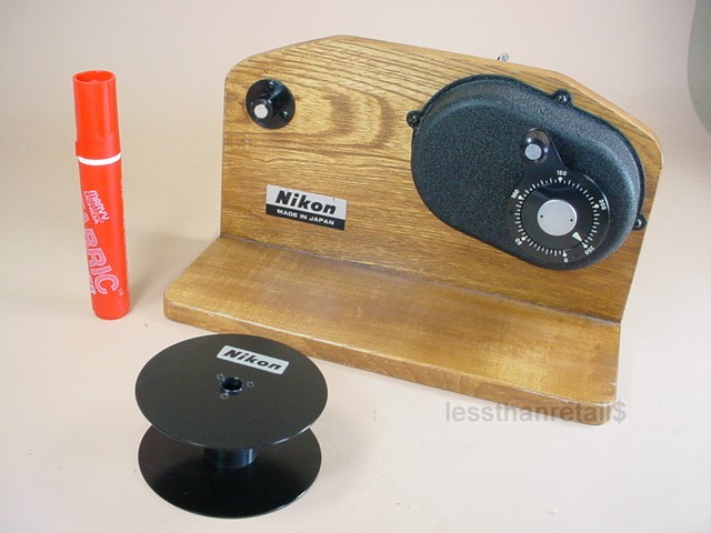

I wonder if you could make something like the Nikon winder.
