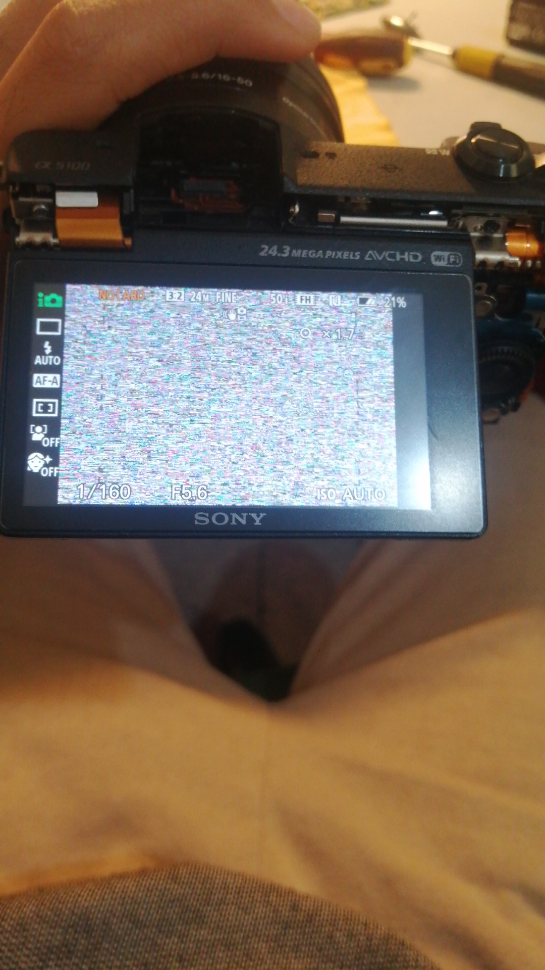

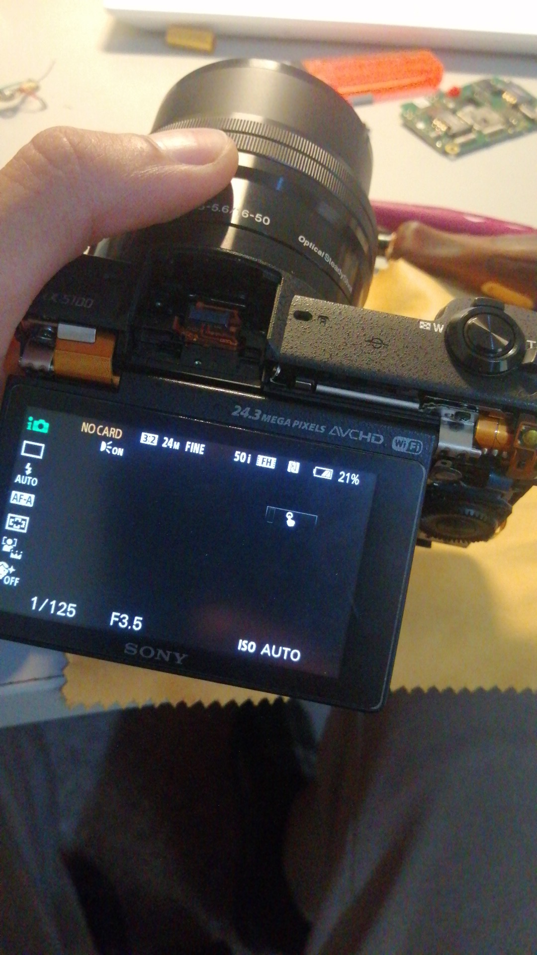

Hi guys, I'm new here.
I hope everyone is doing well.
This is my sony a5100 i open it to make an external mic input,
And i face this problem even that i remove the input and turn it back like normal still face this problem, no Image viewing i can't take photo video.... And when i try most than 3 times it crashed like the picture below... But when i remove the lens No Crash and still no view image... ...
I dont think is the motherboard problem bc if the problem in it i can turn on camera...
Any solution please help me it's my only camera. Please HELP HELP

Picture 2 shows what is called snow in electronics. It says no signal from the sensor is reaching the display. Picture 1 says the display is working.
Turn the camera off, remove the battery, turn the camera on and let it set for a few hours, turn the camera off, install the battery, turn the camera on and try it again. If the problem continues take the camera to a repair shop.

I checked the manual for this camera-- it doesn't have an external microphone input. I reread your post, and realized you opened the camera to add a microphone input-- this is a non-trivial operation, and one almost certain to go wrong, and it appears that it has.
I don't know enough about the circuitry, or the microphone you're adding, but I would suspect either you've introduced a powered signal to a bus that wasn't expecting one, or you've used a microphone with vastly different impedance.
Good luck, but no one on here will be able to help-- you need to take this to a Sony trained technician. shutterfinger's advice is probably the best you can get.
