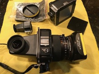

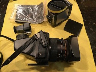

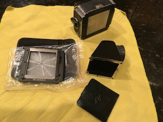

IIRC there is a ground glass accessory for the SWC that you put in place of the film back to accurately focus the camera for a photograph. Using that same piece on a 500 would allow you to accurately compare the actual focus at the film plane to the image on the view screen.
I use that adapter and then put a prism or mirror to see the focus plane.
