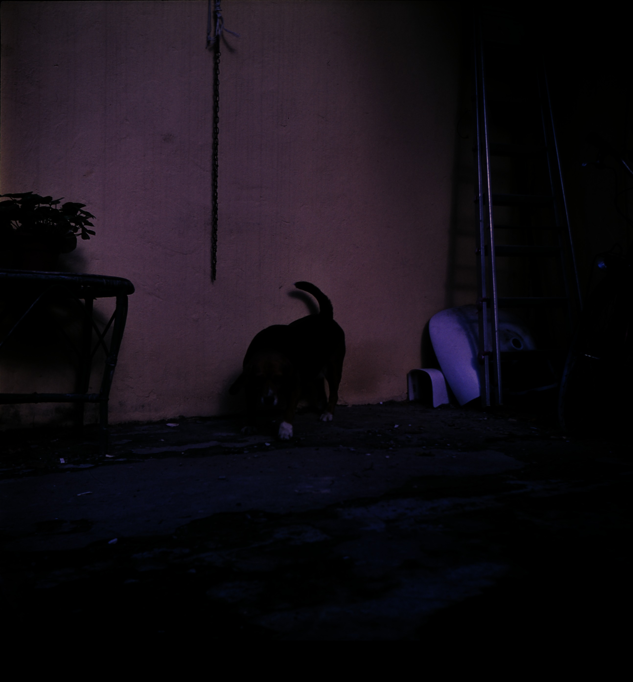

Hi,
my only medium-format camera is a Lubitel 2.
When I had the Rollei kit for developing C41 films, before throwing away the exhausted dev/bleach/fix liquids, I decided to shoot a 120 Ektar 100 and see if the camera was working.
I was right, the camera was in perfect (meh) state. (1)
Fast forward to January 2015.
Two weeks ago I finished a roll of Fuji Provia 400X. The film expired in 2012 (2), but it has been always kept in the refrigerator.
As a lighmeter I usually use a Gossen Lunasix, but since it's bulky I switched to an iPhone Lightmeter application. (3)
At the time of shooting, I thought that the f-stops/time combinations suggested by the phone were right, or at least logical. (4)
Last week I brought the roll to a laboratory for having it developed. It wasn't my ordinary lab (the latter is 15km far from me while the other is 4-500 meter away from my house). (5)
Usually, with the other lab (the one furthest) I had to wait two-three weeks because they develop and print only C41, so E6 film has to be sent to the mainland.
Today I received a text from the lab in my village saying that my film was ready.
When I got there, I was welcomed with "There are no images here, except one". (6)
At first I was ":blink:" then I payed and got home.
The developed film is BLACK.
I suspect that it has been X-processed (7) because if I scan it a slide film the resulting image has a heavy blue cast but, if I scan it as a negative then invert the colours, I see "more natural" colours.
Samples attached to this message.
What do you think? Please, refers to numbers for pointing out possible mistakes made by me.
First photo ----> scan as a slide film
Second photo ----> scan a negative film then inverted in Mac's Preview app.

If it had been cross processed there would be negatives on the roll instead of positives. It just sounds as though you underexposed. I've played around a bit with various phone apps as light meters, both using the camera and the incident phone light sensor, and they've all been hopelessly inaccurate. So much so that I wouldn't use them for print film, let alone slide.
Rudeofus
Aug 13, 2009
5,081
EU
A few things come to mind:
  • That dog appears darker than the wall behind him in both scans. That's very odd if one is a negative scan and the other one a positive scan. Please explain how this could happen ...
  • An easy way to determine whether your film was cross processed is the rebate. Whatever your camera did, the frame edges were (hopefully) unexposed except for the imprints done by the film manufacturer. Can you see these imprints?
  • You can calibrate your iPhone/Lubitel combo with a short roll of B&W film. Take a series of images of some scenery with varying exposure settings, determine the minimum exposure needed to get decent scans, and compare these settings to what your iPhone tells you. If may not be overly accurate, but it should always err by the same amount.
  • Some cameras are suitable for slide film, and a Lubitel may not be one of them. Slide film has less than a stop of latitude, whereas you can overexpose negative film by four stops without any problems.
1) ? The dog is darker than the wall. The negative scan has been tweaked in OS X's Preview by switching the white and black sliders.
2) I can clearly see the imprints. They are dark-orange.
3) From now on, I will always use an "official" lightmeter
4) Well, I do realize that shooting slide film with a Lubitel sounds silly. I just wanted to see a medium format transparency... :/
If the dog is darker than the wall, why does the slide scan show a black dog in front of a blue/purple wall?
I just checked one of my medium format Provia 400X slide strips, and the imprints are dark orange on black background. It appears you have properly E6 developed strips that have been way underexposed for whatever reason.
This won't help you if the shutter or aperture of your camera is out of spec, and with some bad luck randomly so. Invest a roll of some cheapo black&white negative film to find out if you can't measure shutter times by other means.
Medium format slides are way cool, but just like 35mm slides they require careful exposure and reliable equipment.
I can't give you a logical answer. I guess that colours are messed up because of a huge underexposure...
I'll do some tests for measuring the shutter speeds.

There's nothing wrong with shooting E6 in your Lubitel, but its almost certainly the case that you underexposed the film by at least 2 stops - probably more. You can blame either your light meter app (probably user error: you set the ASA wrong or something) or the Lubitel shutter is misbehaving - a problem they are known for. (Usually the shutter sticks OPEN during an exposure, which would not account for your problem) I strongly suspect you underexposed your film through user error. However, if you need to verify the camera functionality, just shoot and process a test roll of your favorite B&W film. Test as many of the shutter speeds as you can, or at least a couple. (Yes - I know - it only have five shutter speeds! I have one too) Be very careful to meter the scene accurately!

This is incredible. I've shot another roll with a hasselblad 500cm and metered with a Lunasix Pro. Again, positives are almost black, which isn't black but blue.. How is it possible? Is it because the film expired a couple of years ago?

Can you confirm again that the edge numbers look correct? Do you see anything in these images at all? Do they look like weak images behind high density? Are there any point light sources in these slides which show through the density? If you look at the slides from their matte side under an angle, can you see an image?
Slide film, expired by no more than a few years shouldn't behave like that, and if it goes bad, the results are brighter slides, not darker ones.

Yeah it's unlikely (though not impossible) to be the film itself. This is astia expired about 10 years, put through XTOL as a first dev and then C-41, and DESPITE all that abuse manages to produce a perfectly fine image
As said above, what are the edge markings like? Have you put a roll of B&W through the same camera and developed it yourself as a sanity check that it's not the camera? Did you get this roll developed in the same lab?

Its' frustrating because I developed a roll of Delta 3200 and it came out good.
Edge numbers are very bright; if you look carefully, pictures do not seem weak. They are high in contrast but very dark. Highlights are rendered quite good, but there is an overall blue tint.
The entire roll is useless. I do know how to expose a positive film, because I've alredy done that so I don't know what to think.
