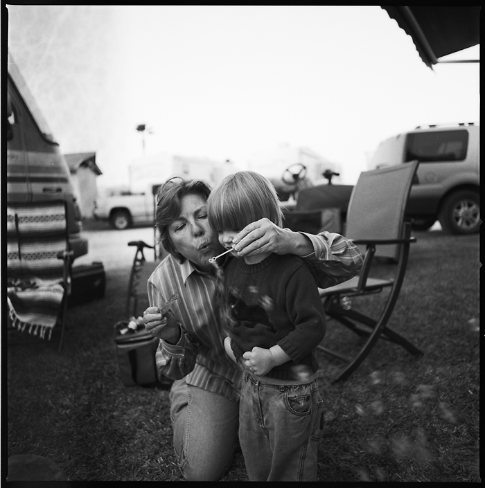

Okay, so I have a negative that has some qualities that I really like. Deep midtones, with light highlights. I shot this last year about this time (winter) with the Hasselblad on either HP5 or Delta 400. Developed in either ID11 or Ilfosol (can't remember and my notes aren't that specific.
My question is, do lower midtones with adequate highlights come from a specific developing combination? For instance could I have underexposed this and lengthened the development time to keep midtones low, but only raise highlights? Is is due to the cooler temperature (here in Texas), as I usually cut my development time in the Summer/Spring, as I can only bring my temp down so much in the darkroom here mid-summer... Or is it just the lighting? It's just open shade - so I doubt that.
Here is the neg - you can see that the overall tone is dark - which is what I like - but the highlights in the skin make it very pleasing for me.

Handheld light meter (reflected) on shade of face. I don't care about the sky here, just an example of how I like my skin tones and midtones.
So you overxposed and overdevelop - which I understand, but you also alter your agitation based on lighting? Brilliant! So if I am Using the standard ilford agitation recommendation - how would I alter that?

Looks to me like the result of a nice fat thick negative and some blueish light.
markbarendt
May 18, 2008
9,422
Beaverton, OR
I'm betting on the lighting.

In terms of flat lighting or open shade a good exposure and slight overdevelopment will make the print glow, as if the light were coming from inside the print rather than from a light source in the photo (sun, lamp, etc). Think of some of Ansel Adams snow scenes, shot in that flat gray winter light. They radiate light from the print.
Avedon's "American West" portraits were shot in open shade, and processed this way. It can be stunning.

Katie, then is it slight camera shake? Can you post a blow up of the boys hair?

I think that what you are liking the most is the appearance of your mid-tones.
Changes in exposure affect the shadow tones the most, followed by the mid-tones, with the highlights the least.
Development/agitation affects the highlights the most, then the mid-tones next and the shadow tones the least of all. It also has a big affect on the local contrast.
Your open-shade plus RV reflection lighting segment gives you great gobs of blueish, low contrast light. So your negative can stand a fair amount of contrast boost without harming the mid-tones.
I would concentrate on your mid-tones when you meter and adjust your development. Tailor the development so as to get the local contrast in your mid-tones the way you like, and the rest will follow (generally).
You do have to have something close to the right distribution of light though in order to get dark shadows.

This is a neg scan, right? So it was auto-leveled by your scan software. We'd need to see the actual neg with no inversion or auto correction, otherwise it's difficult to tell what you did...
Assuming that it is a bit overexposed and normally developed, there will tend to be less highlight differentiation but a lot of midtone detail, which I think we see.
My suggestion is to shoot the same scene with full subject brightness range in a wide bracket: EV -2, -1, 0, +1, and +2, and develop normally. Make contact prints or scan them together and compare the differences. All will be clear.

Thank you ! Yes this is a neg scan, but my print looks basically the same. When I scan, I do it totally manually and do not use auto anything, so while it's vastly different from printing, gives me a general idea as to how it prints (along with my standard method of contact printing too).

it seems that your negative is over exposed by a few stops and
you might have over developed your negative, by a good 30% using normal agitation.
the highlights while they aren't blocked. they are dense enough not to have many details but the mid tones sing.
to recreate this, i would photograph in a shaded place with open sky
where light can bounce to the sides of your subject ( foam core would work if
you don't have a 3-sided greenhouse ( avedon ), or RVs to bounce the light for you
your meter will read for the sky, but i am sure if you read off a gray card or the palm of your hand
and add a stop, you will notice it is a good stop or 2 different. expose for the grey card/ hand value.
using sprint ( its like ID 11 ) and adding a few mins to development will give negatives that
san+print like that, ansco 130 1:6 for about 8 mins will give you a similar look too,
and mixing about 15cc of ansco into 1L of caffenol C, and not agitating at all for 26mins
will also give you a similar look.

x2, I think much of the quality of tones you appreciate in this picture has to do with the type of semi-soft lighting caused by a partly over-cast sky, with light bouncing around and softening shadows, much like John describes and suggests, and isn't so much related to specific development or exposure conditions (although these play a minor role too of course).
Try looking at shadows and softness of light/dark transitions in your subjects faces. Become aware of weather conditions and how they affect the light outside, and you will start seeing more opportunities to shoot pictures like these.

You might try filtering to knock some of the sky down and getting good tone separation.
In this shot you won't get any clouds popping but it will bring down the sky tone bit depending on filter choice.

BUT - the point of this post is how do I consistently maintain deep midtones with bright but contrary highlights on HP5 and ID11.???
Now that I've had a day to think about this, yes I'm slow, let me start by rephrasing your question a bit.
"how can I control the exposure relationship between two contrary subject sets in one shot?"
There are actually several ways but lets start with what probably won't work.
Sure, by manipulating the agitation you may be able to adjust the relationship between subjects a little but I'd say that agitation is probably better used as a fine tuning tool rather than a rough placement tool.
Im not suggesting a change, just ticking through a list and you've actually ruled it out with your developer specification, but using a Pyro developer might actually do more for you than changing agitation. Still and yet we are probably just fiddling around the edges and there are ways to do this with any developer.
More or less camera exposure is also a loser because this simply slides the subjects, in lock step, up or down the curve; it does not change the printable relationship between the contrary subject sets, only their relationship to the ends of the curve.
If you actually want the two subject sets centered on specific points in relation to black and white on paper, then there isn't much to gain or even much of a choice in placement of exposure other than in making sure the detail is available on a usable part of the film curve.
Now to what can work.
Extending or contracting the printable range, using plus or minus development or a harder or softer paper grade, can actually make a big difference. This option can significantly change where your subjects fall on the paper's curve. In the particular situation you describe, maybe shooting your HP5 at 200 or maybe even lower and then backing off on the development, could be a real fix.
Jose Villa is a good example of someone who uses a lower contrast curve, 400 speed C-41 films instead of 160, in a similar manner to what you seem to be asking for here. Jose shoots at +1, +2, or more at times and has his films developed normally, he has chosen to change curves by switching films rather than development. By using HP5 you have the option of adjusting the slope of the curve without switching films.
Manipulation of the lighting would also make a huge difference. Using the RVs as reflectors is a really good idea, if you have the ability to pick the setting. Fill flash and or reflectors (or a scrim if you need to spread the relationship) are real workable options too when you can't pick the setting.
Changing the lighting of one subject really does change the relationship to the other and I regularly find myself in the darkroom asking myself why I didn't use a flash here. Truly and seriously I always have several strobes in my bag. If guys like Galen Rowell could use fill flash on the side of a cliff dangling from a rope, and use it well; I ought to be able to do it on flat ground. I do get lazy on occasion though.
The last option I'll leave you with is filters. Yellow, red, polarizing, or whatever, they truly change what the film can see and where certain color tones will fall on the curve. These are easy and effective in many situations, my biggest problem is forgetting them.
