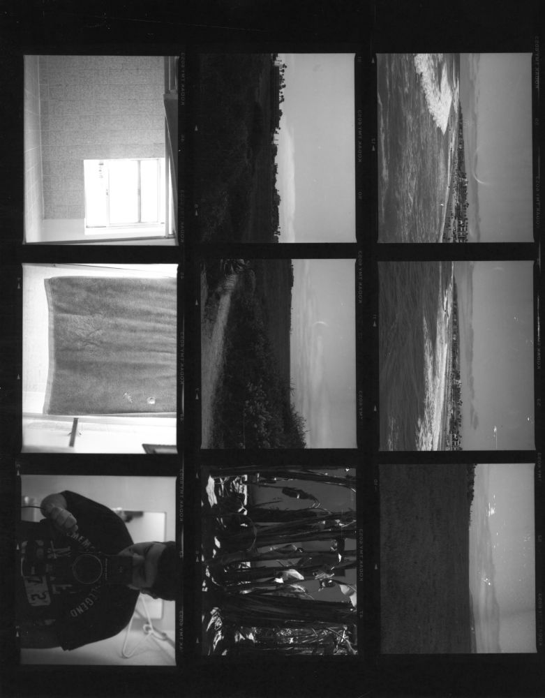

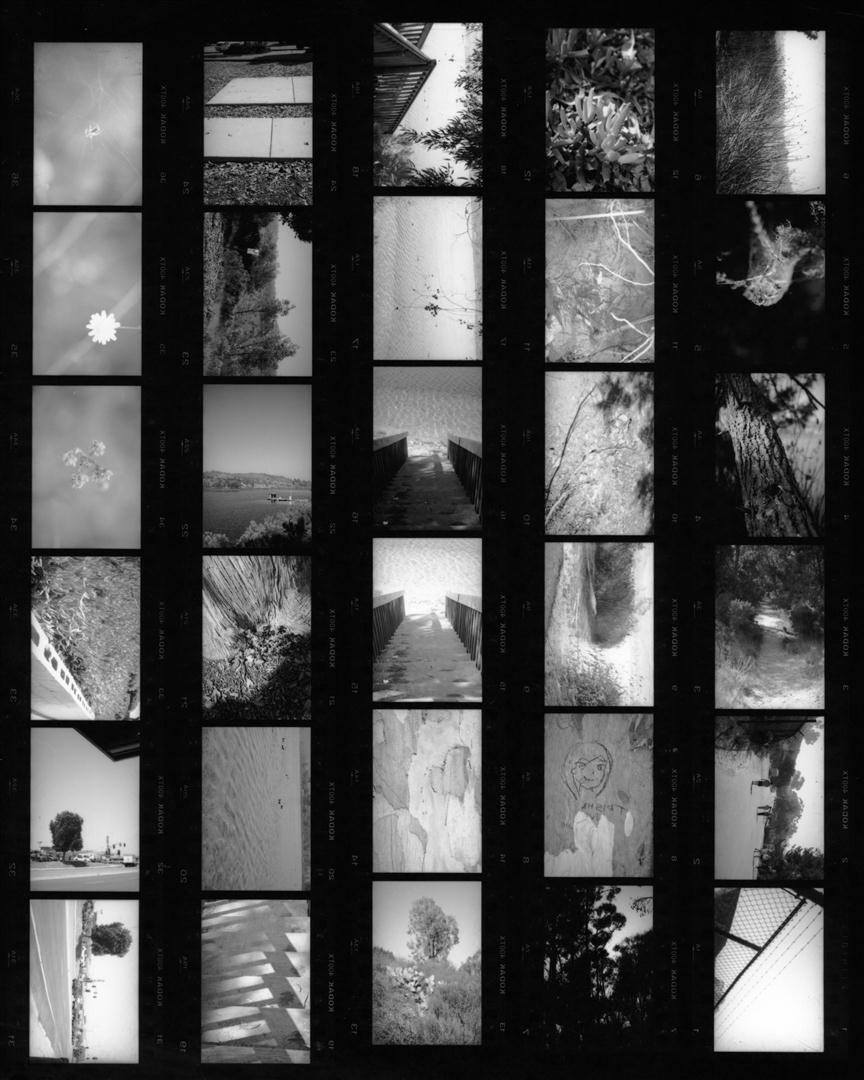

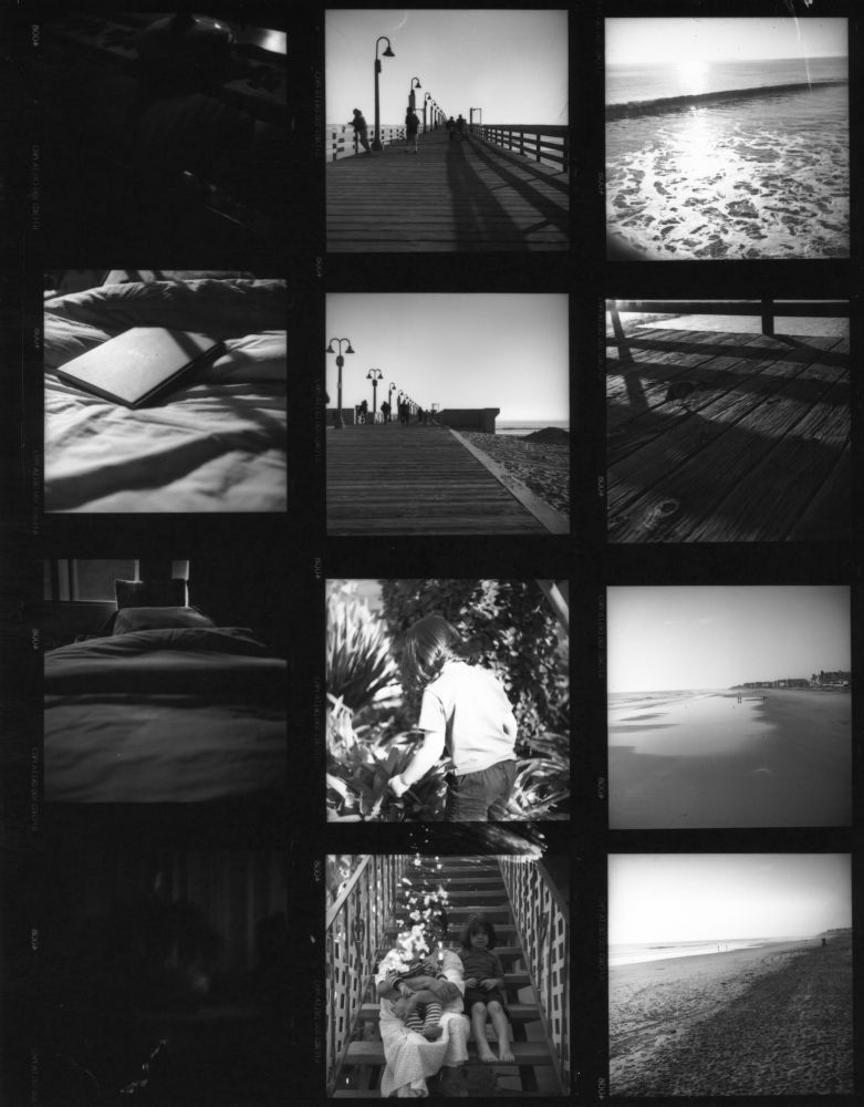

I have decided to do contact prints of a bunch of my negatives, I started with the 4x5s and they printed out nicely. But when I was printing some of my earlier negatives (which scanned really nicely), It seems that the contact prints are really dark, and some are almost black. I contact print using a 7w bulb, suspended about 3 feet above the paper and negatives and exposure times are around 15-20secs. Do I need to increase exposure times to get a usable pictures out of the "thin" negatives? Thanks

You need to DECREASE the exposure time for your thin negatives.
...and you can accomplish this simply on the same contact sheet by exposing for the thin ones, covering them up, and adding exposure to the denser ones.
removed account4
Jun 21, 2003
29,832
hi
why don't you separate the thin from the dense
and contact print the dense ones together, they look like around the same exposures
and the thin ones together as well.
much easier than burning and dodging out your contact sheets ...

Thank you for the replies. I don't know why but I was thinking that if the negatives were thin it needed more exposure time. :D Guess I will just rearrange the negatives (group the dense ones and the thin ones) or maybe print them into strips as most of them are 6x6. Thanks to all.

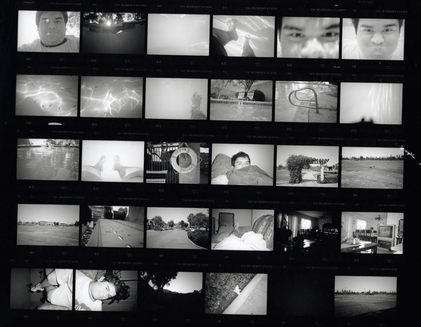

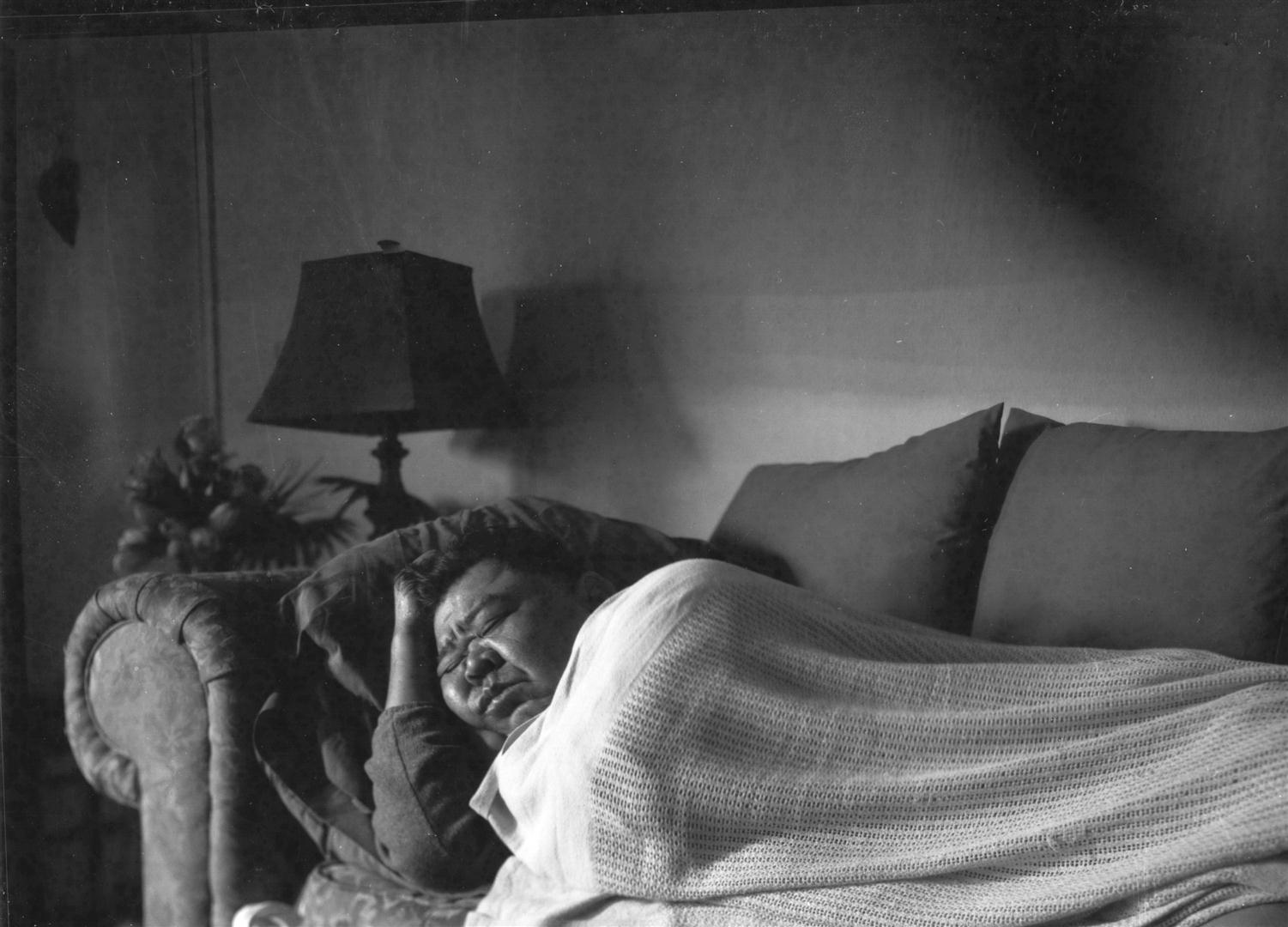

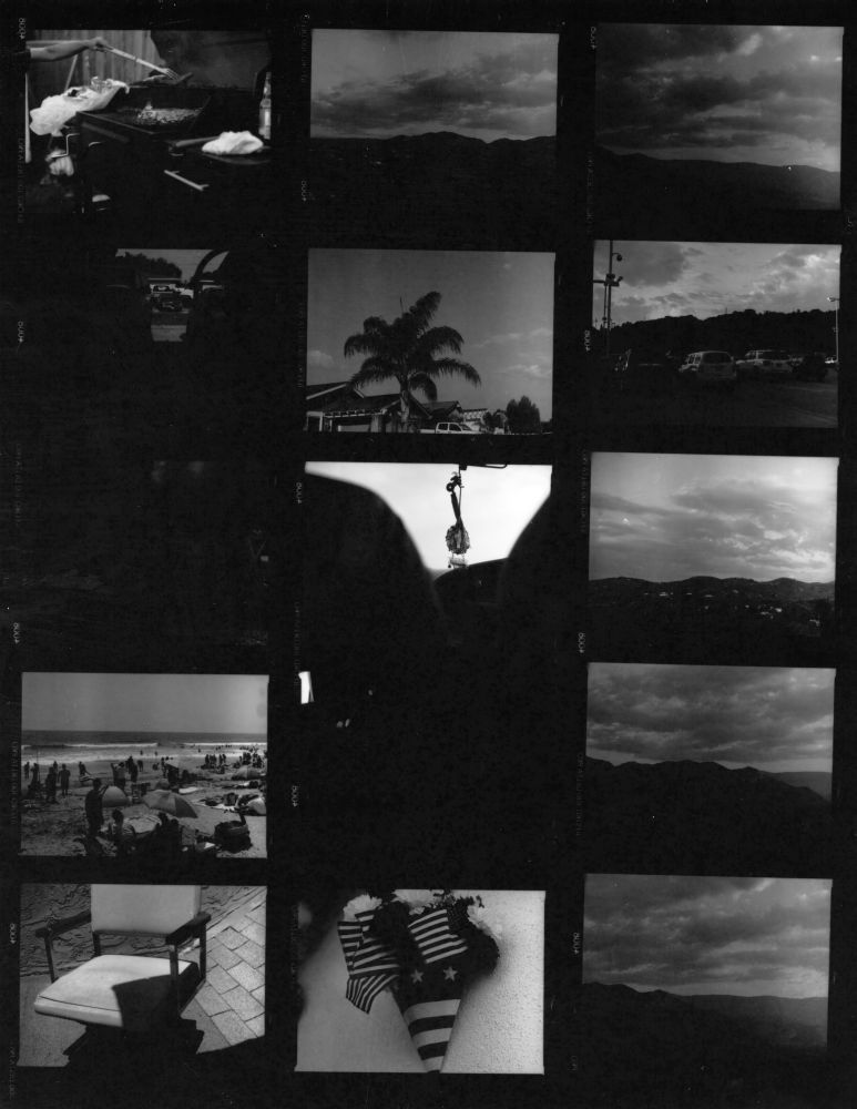

A small update, looks like my exposure times are too long, got a bit better results with exposure times of 5-8 seconds. But I still have a long way to go. :D

All contact prints for negative review should follow the same criterion: max black in min time.
That way you can see which ones will print the easiest, and you can compare contact prints with each other!
