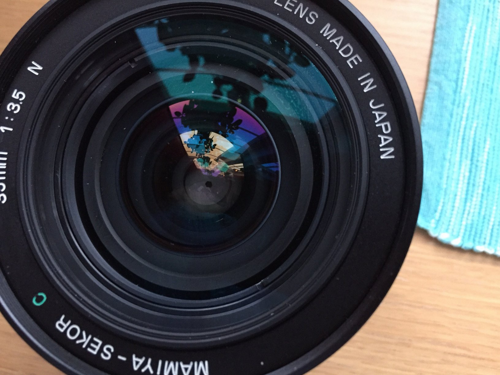

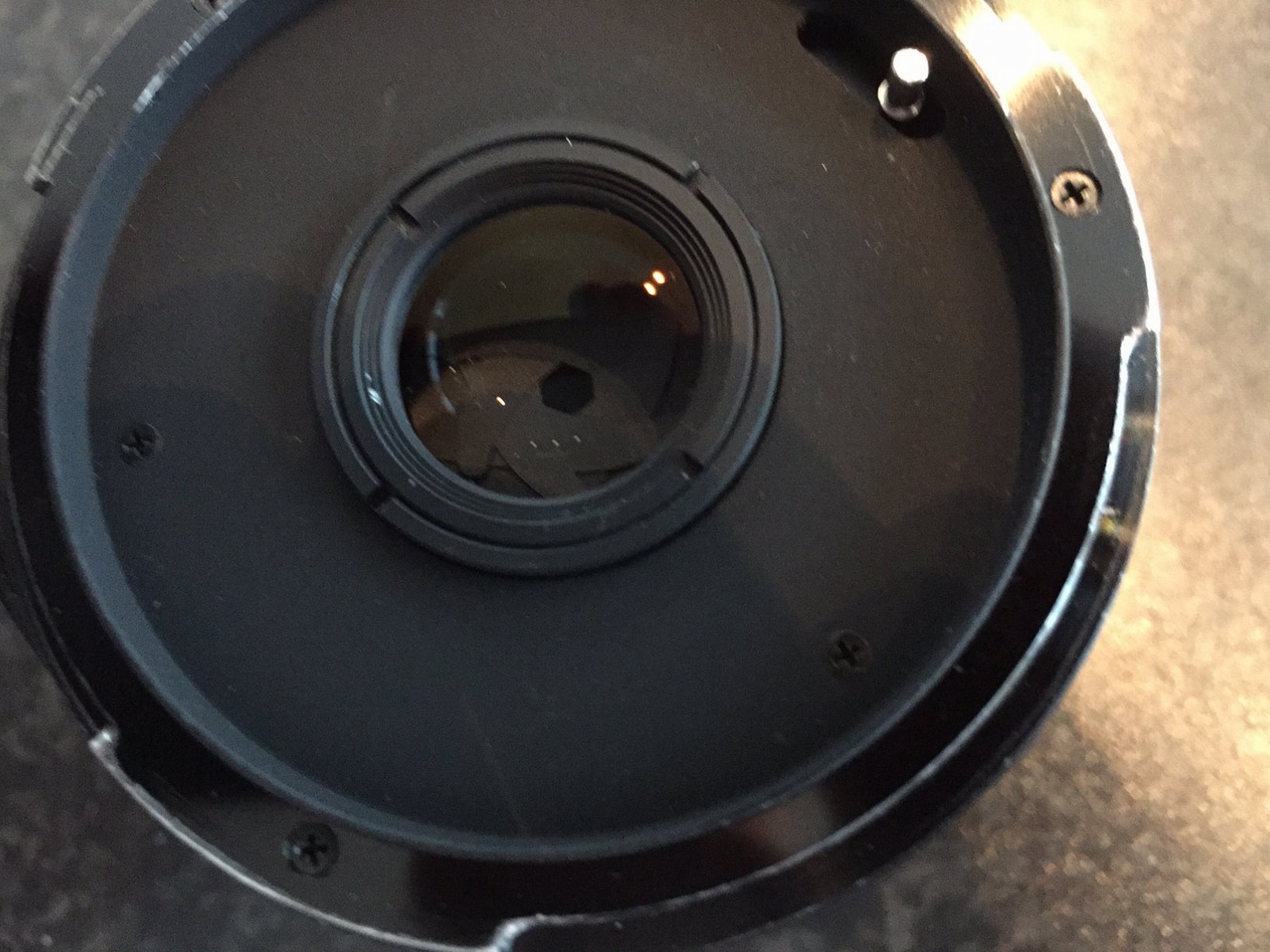

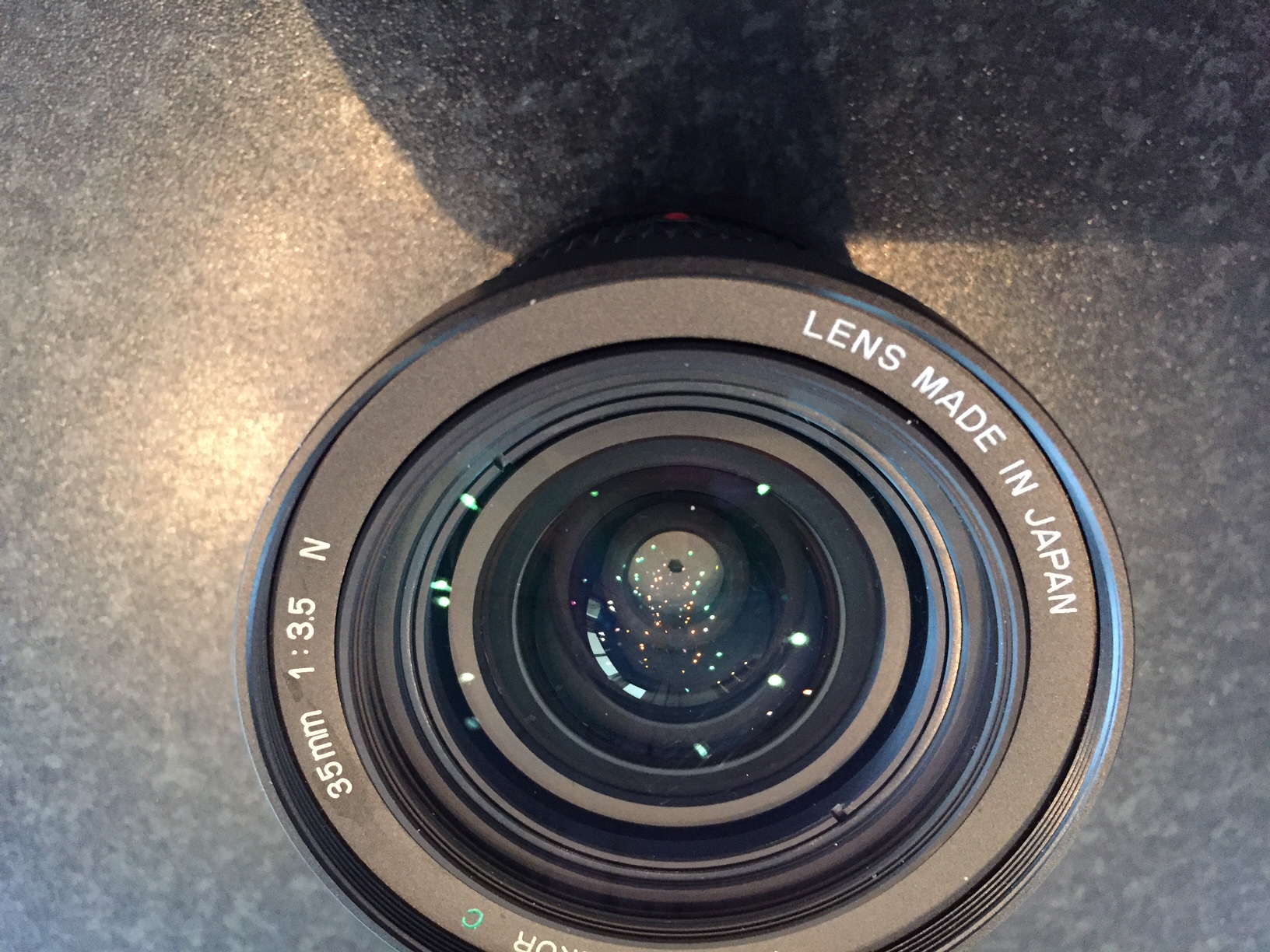

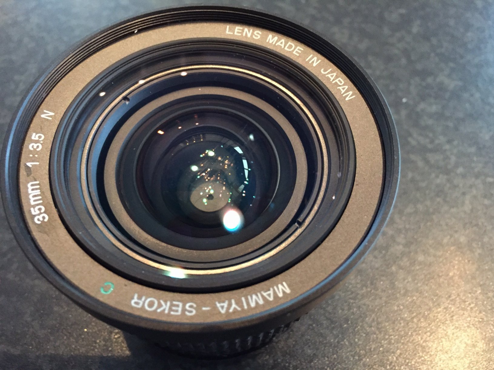

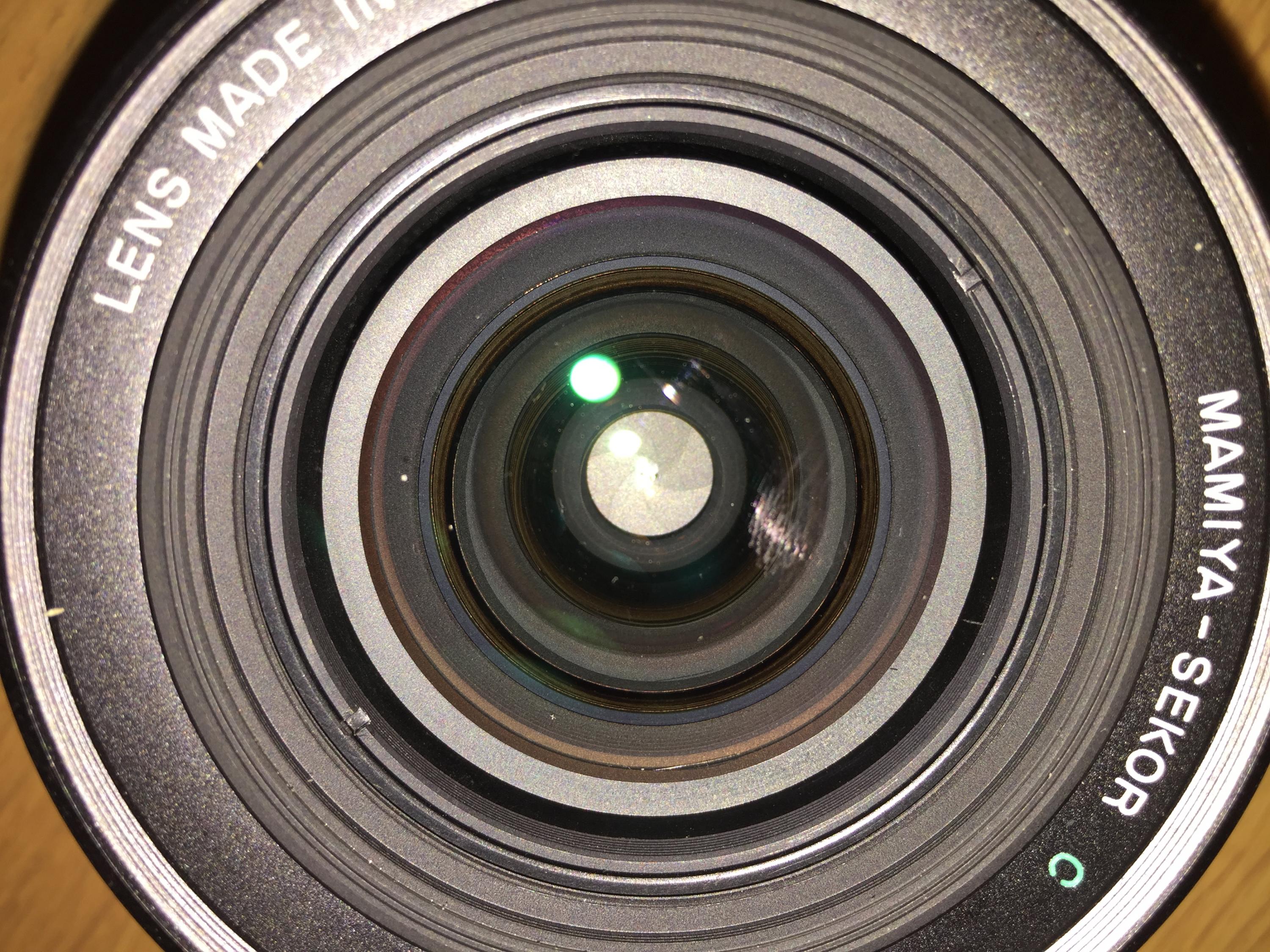

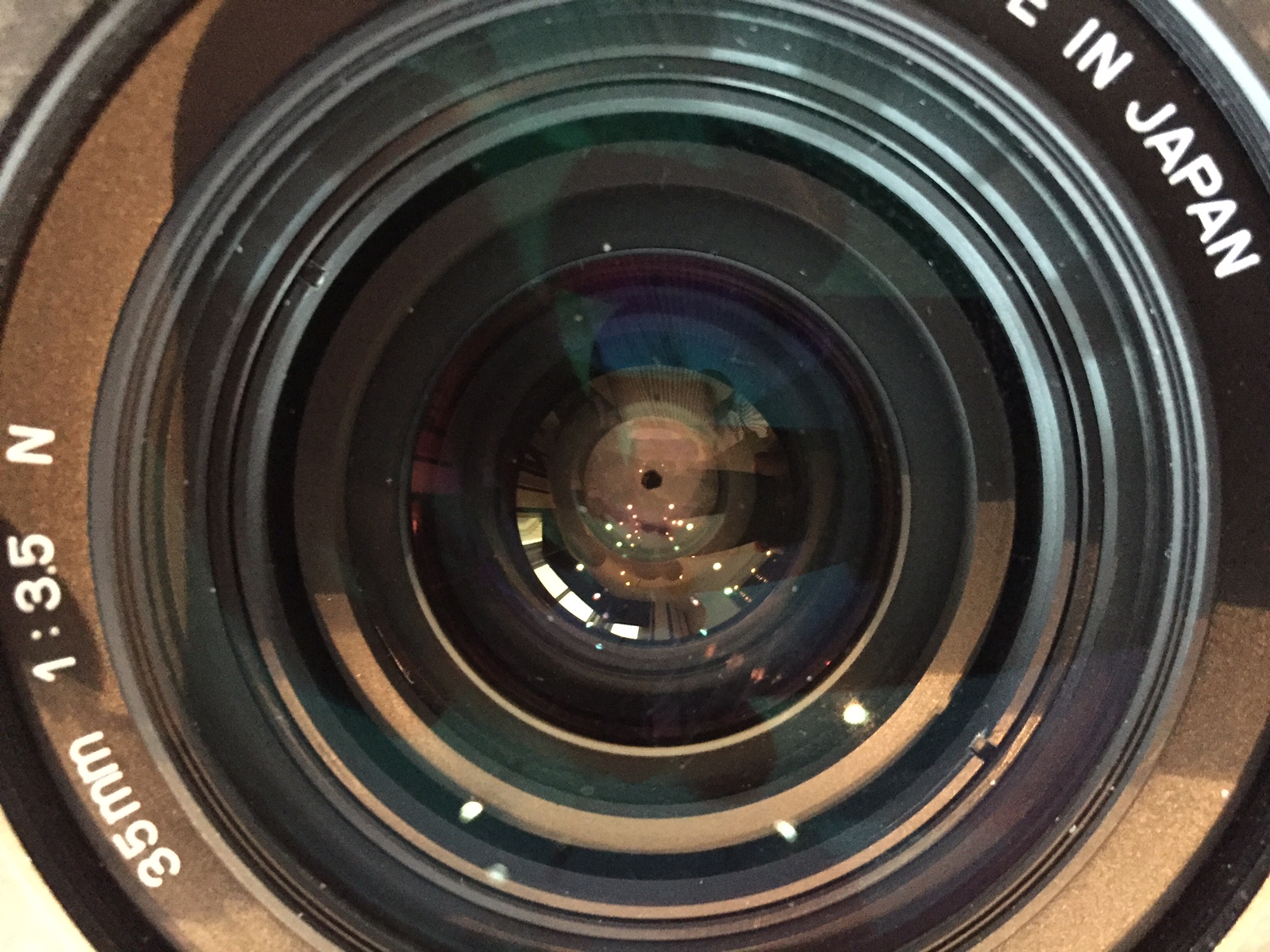

Hey everyone,
Im looking at buying this lens but its hard to ascertain whether the marks are rub marks into the coating or just bad cleaning jobs that are actually just on the surface. Will they affect pictures anyway? Its a 35mm 645 Mamiya C lens so will be used for landscape and some high contrast scenes.
THe current owner is not being super helpful...
Thanks in advace,
Daniel

All other things aside, I don;t see anything with the lens that would get me too worried. I've used much worse. The rub marks almost look like they'd come off with a proper cleaning. At the very worst, there may be a negligible reduction in contrast. If the price is right, I'd go for it.

Of course, when I'm selling lenses that have tiny scratches that only appear when you shine a light through the back of the lens, people freak out like it's the end of the world and only offer $10. Meh.

I'd guess those marks are permanent, otherwise they would be removed for the sale.

The mark at the 4 o'clock position looks like a fingerprint smear.

those pictures dont show the glass condition.
too many surface reflections, no through the lens open aperture photos and he's being a jerk?... all red flags, unless the price is rediculously low to begin with.
