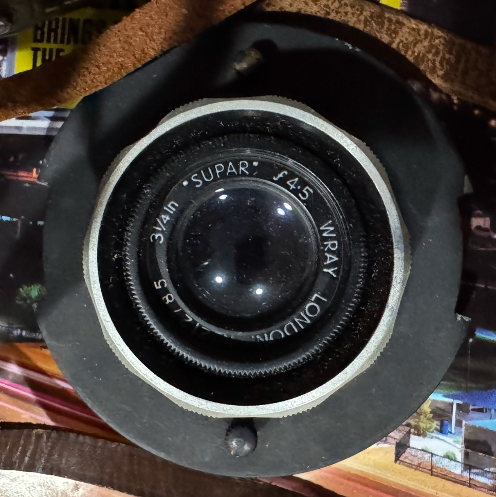

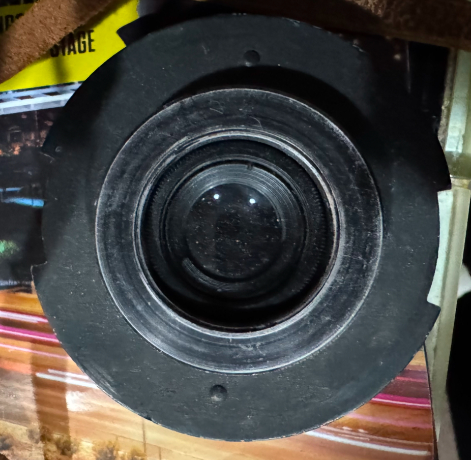

Help me identify this lens and mount? Enlargement or large format?

Yup - spot on Dave.
It's an early Series II or Series III amateur budget enthusiast enlarging lens made in a variety of focal lengths - not very well corrected simple design by the by the former Wray factory near where I live in Bromley, Kent. The factory was more famous for its Wrayflex camera and the later more innovative 135mm f4.5 enlarging lenses as well as Lustrar lenses.

Thanks.
