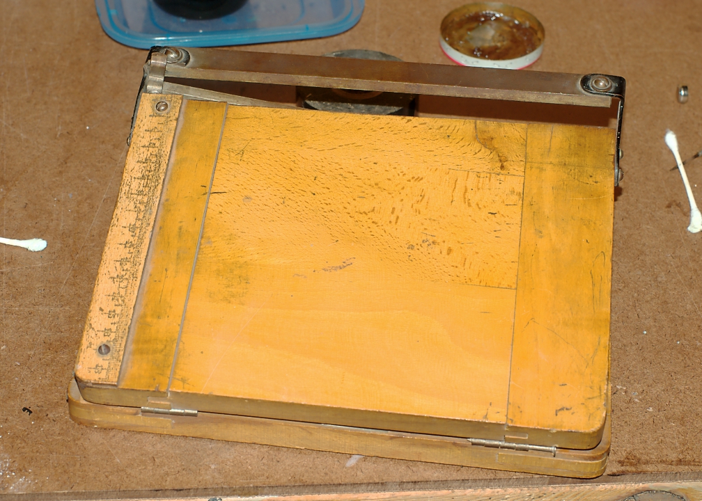

The wooden object look like it could be a contact printing frame, with glass missing and the backing plate missing. Looks like a metal spring plate to push the backing plate forward and compress the negative into solid register with the paper. Not sure if this is from the age of printing-out paper

Dan,
I originally thought the same thing, but that squarish frame is just the bottom of it that sits on a table. After playing with it for awhile, it turns out to be a paper/film cutter. You put the paper along the paper along the ruler edge, letting the excess fall between the metal bars and push down on the wood. That half of it moves down and the metal edges cut it like a giant pair of scissors. The piece of springy metal pushes it open again. I hope the picture shows it well. I wonder how prevalent these where - it has no brand name or any other identification mark on it.
