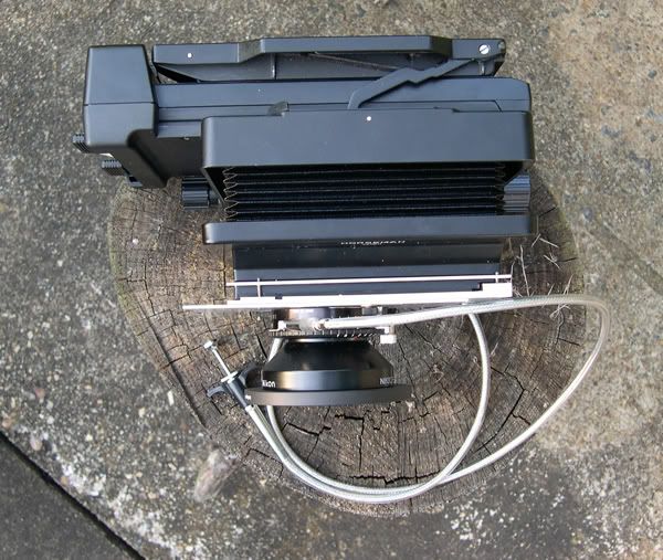

I made a nice wide rig from a 4x5 enlarging back. You can put any lens on it. Don't need GG to focus, you can make distance markings on the rails. For now I put a 65mm lens on it, but it can go much wider. Normally I put a 6x12 back on it or shoot 4x5 quickloads.
The RB lenses are *heavy* and I can't mount them on anything less than a sturdy rig. A crown graphic, for example, can barely take 'em, in terms of stability. So it depends what your vision is for this rig.
For infinity focus, you must be able to bring the lens quite a bit closer to the film plane than you would for closer-up work. Also, at infinity you will have the smallest useful image circle and are hence most likely to have vignetting.

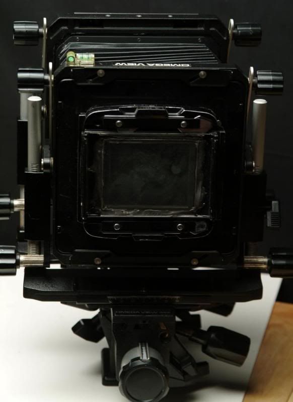

Or, possibly a rotating back, a little bit of luck and some hunting on ebay. Personally, I use this approach (though I need to build another lensboard, as Keith just had to have one...)

I thought about the RB's native lenses, but I don't want the RB in between 'cos I want this to be a sling-it-o'er-your-shoulder-and-carry-it-about camera, and don't particularly need reflex viewing.
How does this grab you?
65mm f/4 Nikkor on slightly modified 4x5 enlarging back, with ~3 cm of shift along the long axis. Zone focusing is easy peasy via markings on the rails, no GG required. In the photo, the back is the PA45 Fuji instant packfilm holder. You can put a much wider lens than a 65 on it, of course.

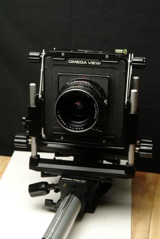

Erie, that's very cool. I've always wanted to try mounting RB lenses on a view camera. I've heard some will almost cover 4x5.
