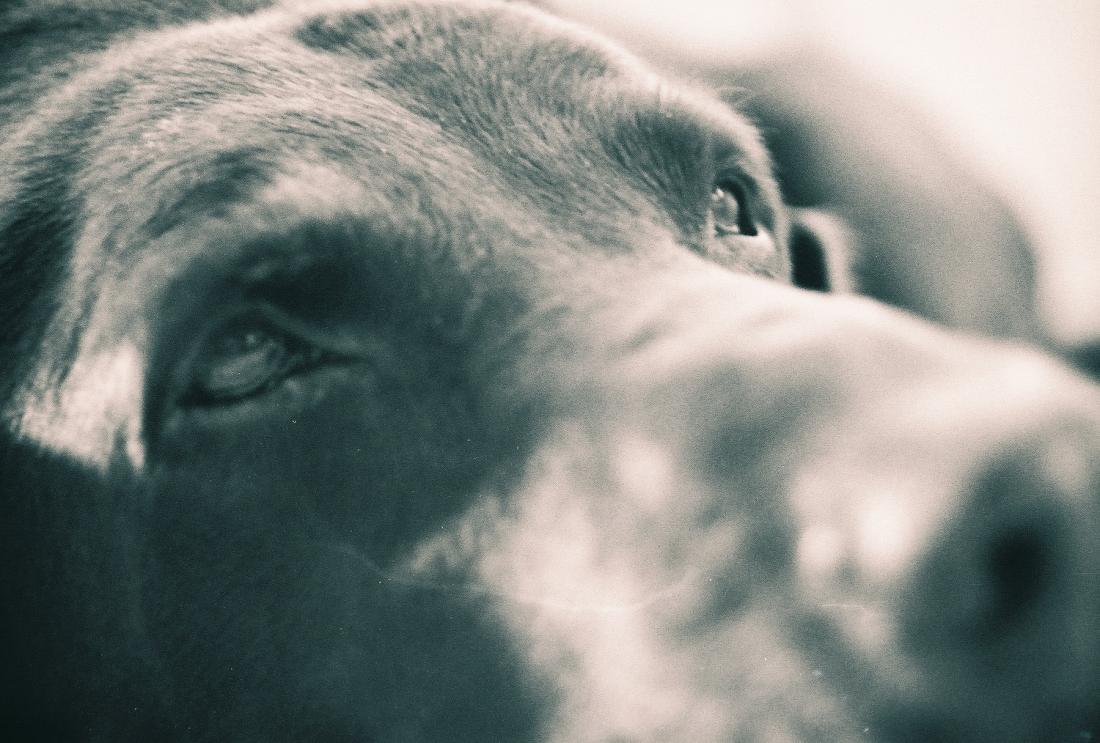

I mixed all of my chemicals with distilled water. I did the stop bath with distilled water and the final wash too with photo-flo. Im still getting stains on my negatives! Please help me because I feel hopless. Im gonna post some shots from a test roll of Tmax 400 developed in Tmax dev. After the roll dried off, I did notice some spots or stains. I used rubbing alcohol(70%) on the base side with a q tip, then i wiped it with a lint-free cloth like the ones that come with sunglasses. Please help!
The pics are over exposed because I havent edited them yet so you can see what im dealing with.

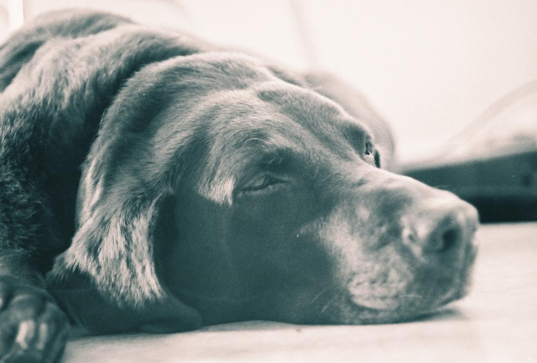

It's a little difficult to tell, even with the photos. On my screen there seems to be a tinge of pink on the photos (I assume you've made negative scans); that may suggest inadequate washing. The second photo seems to show residue or stain from a water spot left over from the drying process. Are you sure that your fixing time was adequate? The T-Max films require a longer time than traditional films. Five or six minutes in Kodak Rapid Fix or about double that in a standard fixer is usually recommended. That's about all which occurs to me now; perhaps others with better eyes (or screen) will pick up on something else.

Your problem might easily be solved by switching from photo flo to Edwals LFN. Your marks look like wetting agent problems to me.

that looks like a fixer issue,, i fix for 10 min. when i first started dev my own film, i was getting stains like that. it wsa the fixer
THAT's the problem! You hung the negatives horizontally! Is it possible that as you hang the negatives horizontally, some part of negatives had water collecting on its surface and dried in place? A common practice is to hang it VERTICALLY with clip on top to hold it in place and clip at the bottom to weigh it down. That way, all the surface water will drip down and not pool on the surface.

The stains I am seeing look like drying marks. There was another lengthy thread on this issue a while back. I would repeat the various comments I made throughout that thread (see link below):
Yes drying marks and I said as much in an earlier post.
Vertical or Horizontal, it makes no difference if all the
surface water has been removed. For the complete
removal of surface water I use an eight blade
FILM squeegee. It follows the film in use
of a half strength Photo-Flo. Dan
