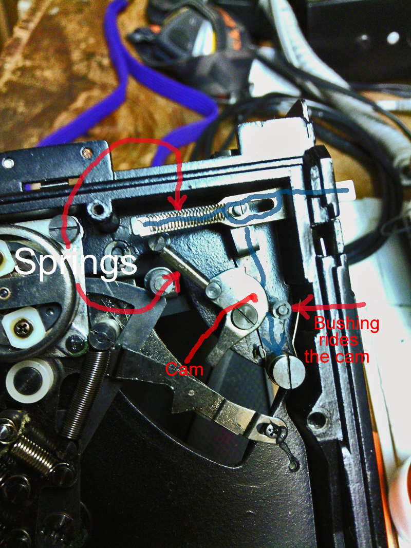

That could be a few different things causing those tabs to hang. They run dry so lube, a very light oil (watch oil) may free it up a bit and cure your problem. The camera may have sat unused for several years n just needs a jump start... oxidation or whatever. I may have a picture of how those "arms" link inside so you can understand the mechanism.
The revolving back.... those chrome tits sometimes get crud in them when people put the camera on the revolving back without a film mag. The pins either get bent slightly n cant run free, or crud gets in and hangs them up. Clean the hole n push the pins from teh back of the revolving adapter as you work in a very very tiny dab of WD40 in each.
Note... to open this side of the camera, you will have to replace internal seals. This side has a double panel.
the bushing is plastic delrin and rides the cam. This isnt a heavy spring load... its a delicate load as you can feel when pulling the tabs. If its not snapping back, something is bent, or the bushing is worn or a spring is popped.

Northern Italy - Hamburg
