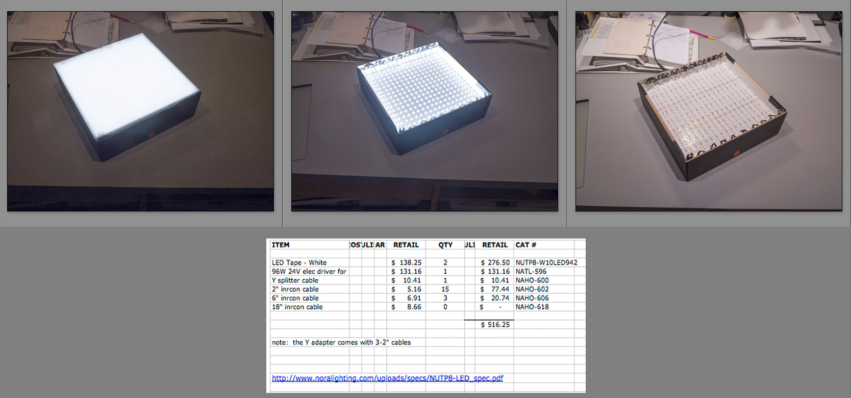

I have made 2 LED heads to replace my aging Aristo 12x12 cold lights on my 8x10 modified Beseler and Omega D5500. I used NORA Lighting white LED self-adhesive tape. The total cost of the parts runs retail $5-600 but well worth it.

Thank you, Alan. That looks really good!!
